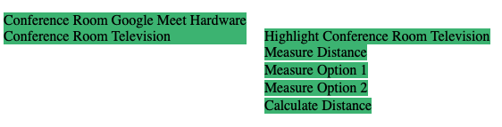

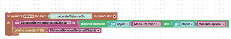

    Can someone please help me understand why this is not working correctly? I have linked the puzzle I am using, as well as the output.
    I am using javascript to get the names of the objects that are being used in the pictured example… But how do I get a numerical output instead of just text?
    #71419
    remove the “create text” puzzles.

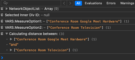

    Here is the output with the modification you mentioned:
    Could it be because the variables are arrays?
    #71434
    :wacko: You are trying to get the distance between two arrays of objects? :scratch: That puzzle can measure the distance between two objects only.

    Sorry, Im not very good at coding so I don’t really know how to explain the issue :mail:
    From the javascript I have written, I push the object name into an array when someone clicks on the div to set it as either “Measure Object 1” or “Measure Object 2”. From there I am hoping to use the string in that array to reference to an object in the scene.
    I have attached some photos of the green div buttons I am talking about clicking, and a snippet of my code so you can see how I am moving the info around. Im clearly doing something wrong as my output is always text :scratch:
    But even with all this, since the array has the correct text (the previously printed console text)- shouldn’t it work anyways when I try to refer to an object by the array? I feel like I am missing something very obvious :unsure:

    Why do you save an object’s name as an array consisting of one element only? What’s the point? Just save it as a string.
    Try this way:
