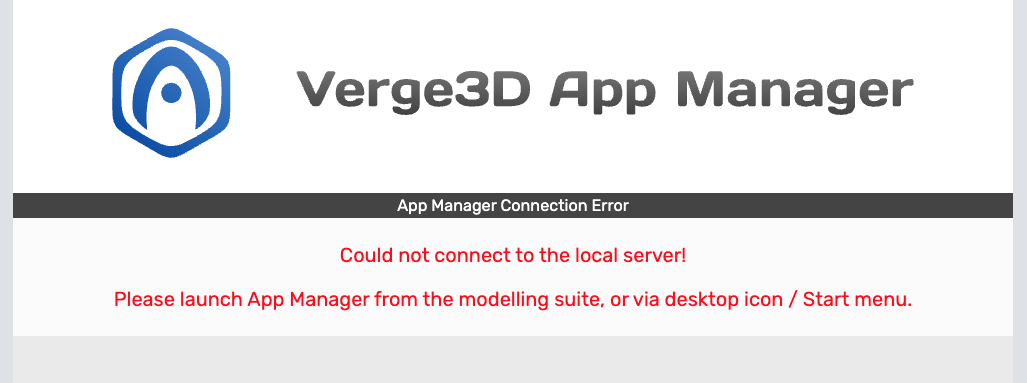

    Hello,
    I’m having trouble with the following issue:
    When launching the Run App Manager inside Maya I get the following error in the web browser:
    Could not connect to the local server!
    Please launch App Manager from the modelling suite, or via desktop icon / Start menu.
    I’ve already updated Verge3D to the latest version 4.1.1 and my MacOS system as well (macOS Monterrey 12.6), but I still cant get rid of the error.
    I’ll appreciate the help and guidence.

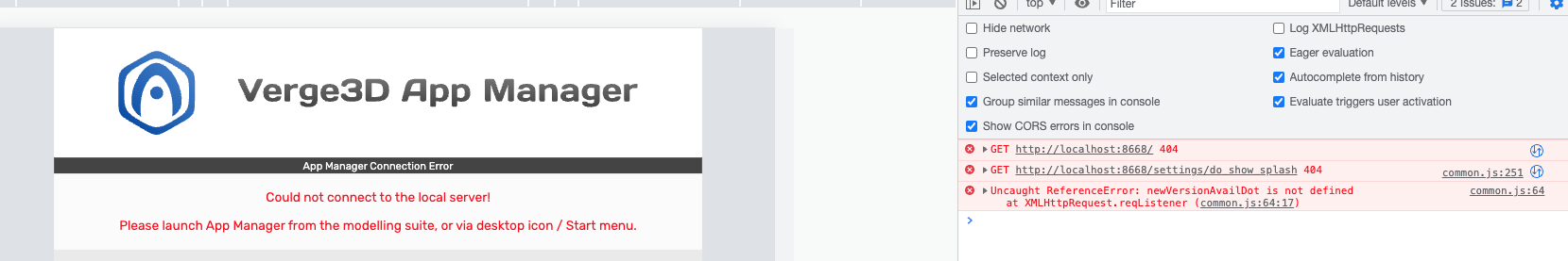

    #55847
    David Yanez
    This is what the browser console shows:
    GET http://localhost:8668/ 404
    (anonymous) @ :8668/:31 setTimeout (async) (anonymous) @ :8668/:31 common.js:251
    GET http://localhost:8668/settings/do_show_splash 404
    window.makeRequest @ common.js:251 (anonymous) @ common.js:153
    load (async) init @ common.js:121 (anonymous) @ common.js:513
    (anonymous) @ common.js:515 common.js:64
    Uncaught ReferenceError: newVersionAvailDot is not defined at XMLHttpRequest.reqListener (common.js:64:17)
    reqListener @ common.js:64 load (async) checkForUpdates @ common.js:74 (anonymous) @ common.js:123 load (async)
