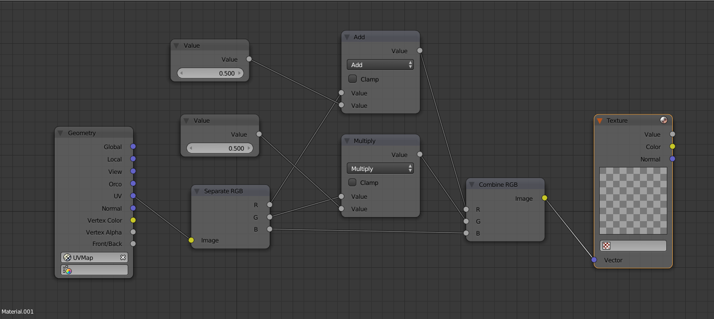

    Pepper KUN
    Thanks , it works. :good: And I wondering how to change parameter of mapping node. It’s not possible connect a value node on it. :mail:
    Noob on blender and any other things.
    #5286
    You can separate it on three channels using Separate RBG node, modify it with Math nodes (Add will be shifting Multiple will be scaling) and combine them together after modification.

    Pepper KUN
    Thank you Mikhail, it work nice :good:
