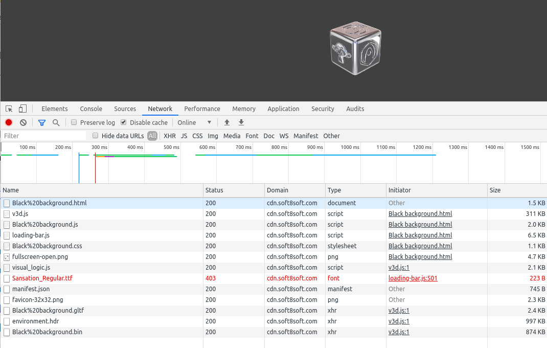

    Black Background
    I did that, wanting to use a new loading bar… but now I lose my world of Blender… a picture hdr of a forest

    Looks like your app does not use the forest background image. May be it was lost somehow?

    I sent you all my files, my problem will be more visible. Why I have a black background, how to do with the puzzle.
    You need to put your preloader div to any div with a background (not transparent) to cover black screen, because when you set a custom preloader build-in preloader dissapear and you see just a black screen.
