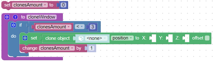

    I want the user to be able to add a specific number of “cloned” objects to the scene. In the example linked here, the user can double click on the window to clone it, but I need to limit the number of “Clones” to 3.

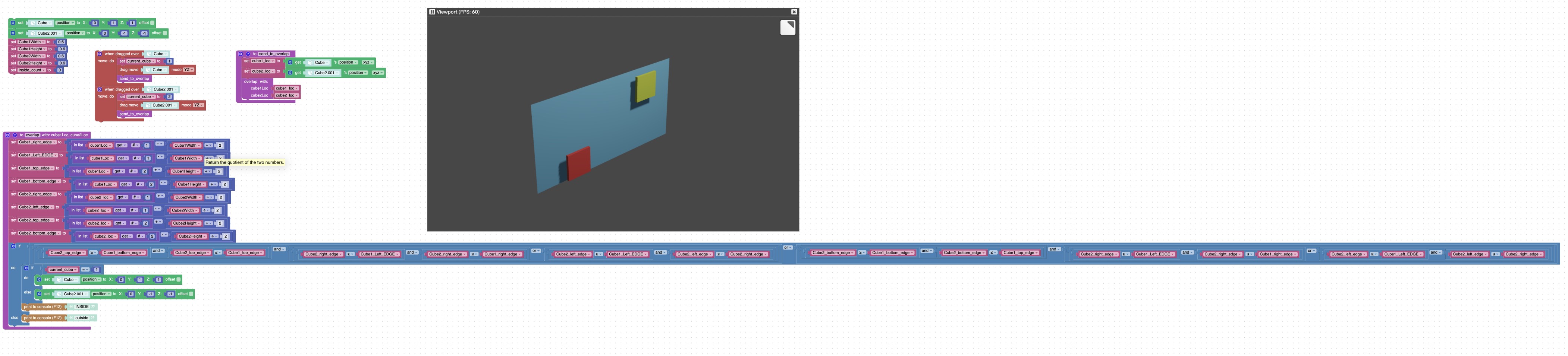

    I also dont want the customer to be able to move the window off of the wall. They must be kept between the trim. The Windows can be moved along the x by dragging.

    Hey Greg,
    As you create clones, create a list of the objects created.
    Then you should have a variable set as the max number of clones you want. Once the count in the list reaches the variables disable the ability to create more clones. The list will be handy to delete, and or hide those clones as well.

    Regarding keeping an object within the bounds of a wall. There are three.js bounding boxes you can use via JS that makes this easier but here is puzzle only version:
    https://v3d.net/7ls
    The application/code and blend file has been sent to your email.
    For those that stuble upon this the trick is using the location constraint in Blender. That will confine it to the wall.
    Adding windows on a wall such that they don’t overall will be the next question. See puzzle image for details.
