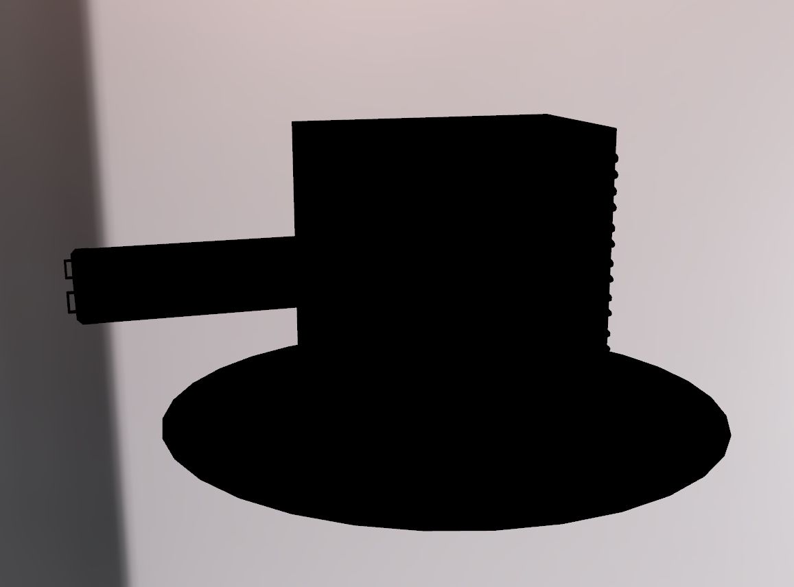

Notice the HDRI image does not appear in the background of the example? Is background set to transparent in puzzles?
When I try it, all I see is the HDRI and a black object:
The Verge3D video on Youtube isn’t much help and is 5 years old.
Any helpful guidance would be appreciated, thanks.

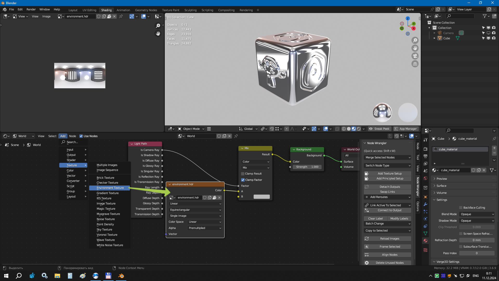

2024-12-10 at 7:53 pm #79319kdv
Participantshow your World’s material.
2024-12-10 at 7:56 pm #79320
jefferywright2194ParticipantI don’t know what that means, show it where?
Thanks.
2024-12-10 at 8:05 pm #79321kdv
Participantshow it where?
here.
make a screenshot and attach it.

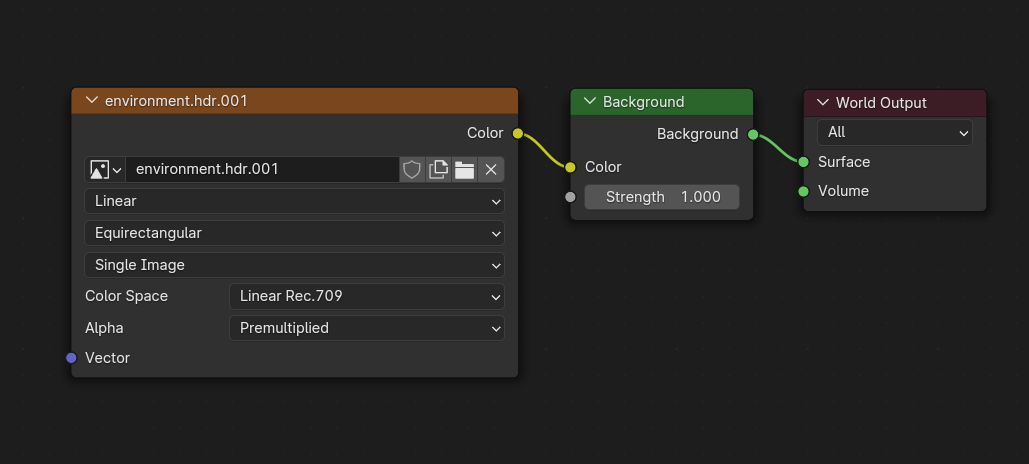

2024-12-10 at 8:09 pm #79322
jefferywright2194ParticipantIt’s just the generic default blender HDRI seen here, the top one:
Why?
2024-12-10 at 8:12 pm #79323kdv
Participant2024-12-10 at 8:29 pm #79325

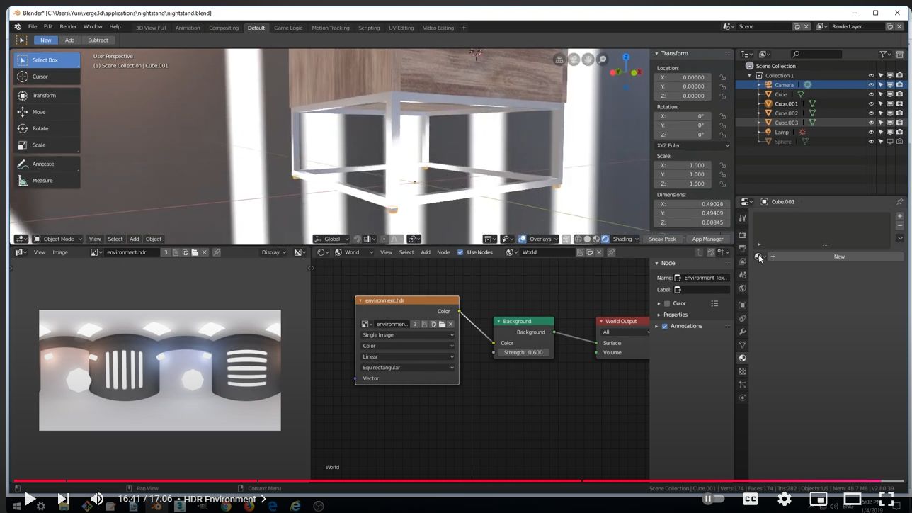

jefferywright2194ParticipantIt is set up like the 5 year old V3D video I mentioned earlier.
2024-12-12 at 2:55 pm #79368
jefferywright2194ParticipantI appreciate the suggestion, which I implemented but still no dice… there must be something else.

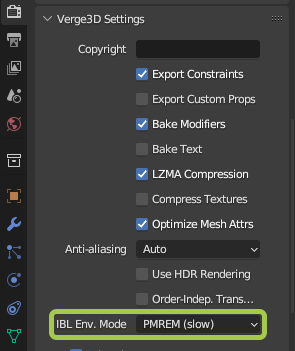

Yuri KovelenovStaffCan it be that the .hdr file could not load?
Are there any 404 errors in the browser console?Also make sure that Render > Verge3D Settings > IBL Env. Mode is set to “PMREM (best)”, which is required if no light sources are present in the scene.
Finally make sure that the World shader is actually assigned to the World.
2024-12-13 at 6:04 am #79375kdv
ParticipantImage-Based Lighting: N/A
that’s the answer. make sure that IBL Env. Mode is not None (fastest).
