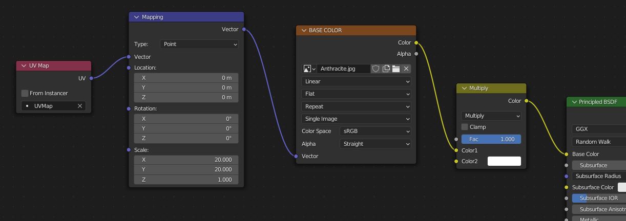

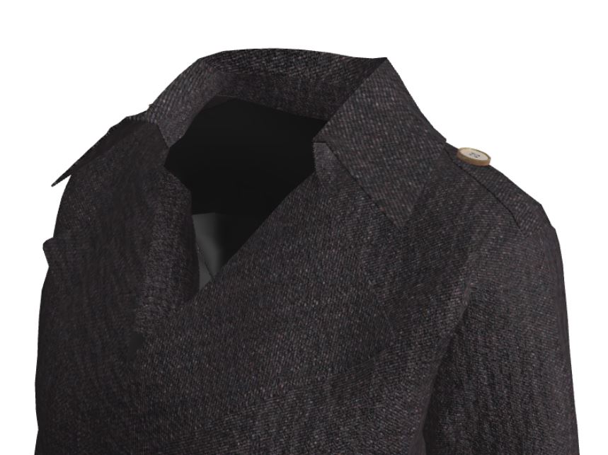

    I am trying to export from Blender a 3D object via “Verge3D gltf binary” with a material that uses Texture Mapping with scale. The material is marked as glTF 2.0 compatible. After uploading to the scene, however, the texture is not at the required scale.
    If I export a 3D object from Blender via standard glTF 2.0, after uploading to the scene the texture is at the required scale.

    My fault, MeshStandardMaterial supports scaling, but Verge3D plugin ignores it. Thus, glTF 2.0 compatible materials exported via Verge3D plugin do not support texture scaling.
    But you can add some scripting to eliminate this problem
    In your case the value is 20 and the material’s name is different…
