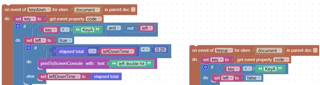

    you dont have to use boolean true false for a state or flag.
    You can set a variable to 0 or 1 or any values you want.
    Your logic will have to determine if the keys were pressed consecutively in a time interval of your choice.

    That said, here is my answer to your question. For some reason, it does not work:
    kurumii
    nor this:
    kurumii
    So how do I fix these puzzles?

    Get rid of them and try to unsee them…
    Math and logic to calculate the time between two consecutive key hits look in a little different way.

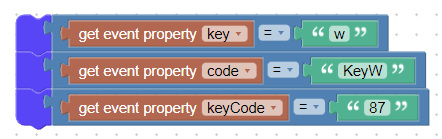

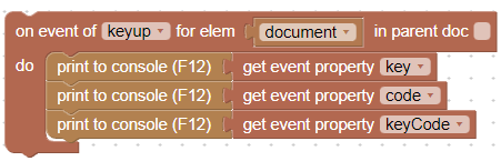

    As usual, you’ve taken a workin’ code and broken it with your unique vision of JS coding…
    The key code “a*2” doesn’t exist in this universe. Use “KeyA”, KeyD”, “KeyW” and “KeyS”.
    You can read any key value in the console log using this simple set of puzzles

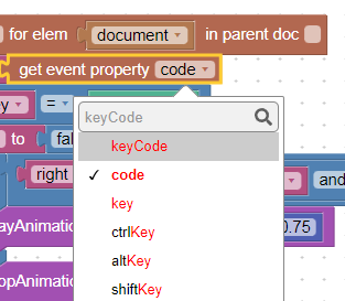

    Sorry, I couldn’t find that keyCode event, in the get event property
    kurumii
    Have no idea why.
    And you don’t need it. key or code are enough. code is preferred, its value doesn’t depend on Shift as in case with key.
