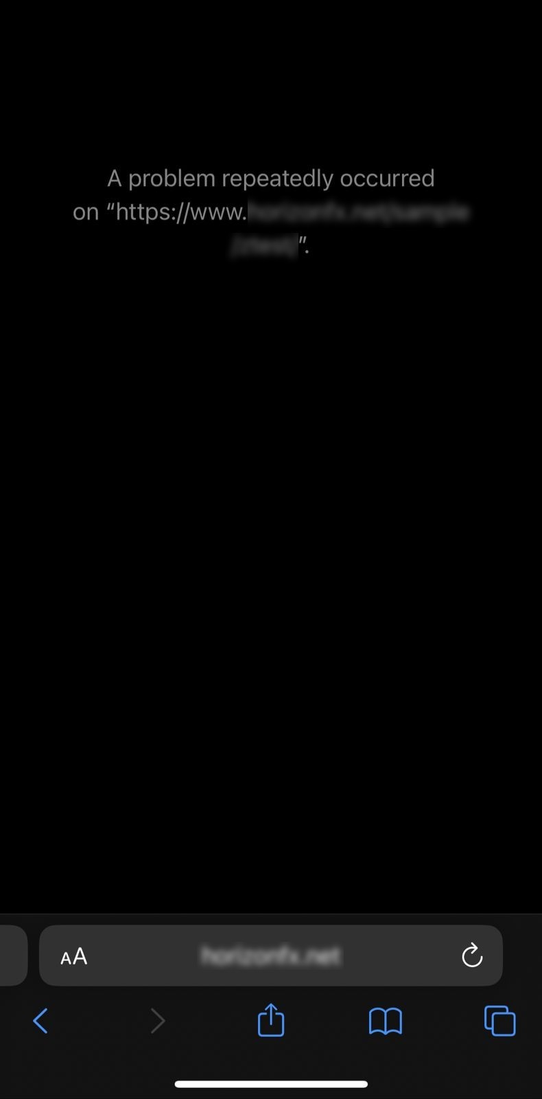

    I am facing a strange issue on some iphones which doesn’t load the scene & at the end of loading shows the error screenshot. see image.
    I saw this in version 4.1 & after changing to 4.3.1 it is still there.
    what’s a fix?

    Optimization. Most likely your app consumes too much memory.

    the total directory size in verge 3d applications is 35 mb that’s all… no chance of any heavy stuff at all. surprising !

    Well, then nothing to say at all without the app itself.
    Are sure? Hi-res reflection probes/planes, multiple lights casting shadows, 4k+ jpg/webp textures… There are a lot of ways to crash iOS Safari…

    Actually fact is it is running well on my iPAD pro M2 ^ not running on iPhone 12 …thats weird.

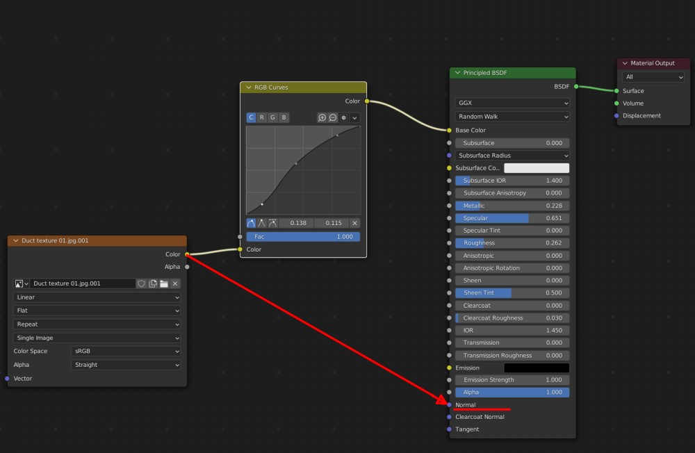

    I could fix it with a little cross checking & found that, the normal mapping connection in node was causing this.
    Its surprising why its not working but when I removed those connection at couple of places the published scene worked on the perfectly which earlier was not working.
    Still wondering why it was so?
