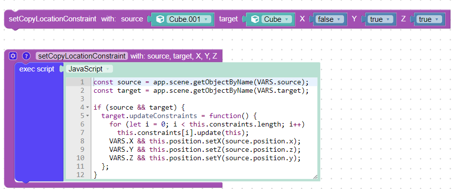

As the title says I am trying to copy the “X” and “Z” location but not “Y” of one object to another, I have tried using blender constraints but turning off individual directions doesn’t work
Working perfectly on my side.
2024-06-13 at 3:52 pm #74841sbs
ParticipantI used a work around of creating a procedure with get location, set location.
I have a large amount of controls which affect a group of objects and I needed those affects to be reflected in those objects copiesNot sure why the blender constraints aren’t working for me
2024-06-13 at 4:03 pm #74843sbs
ParticipantJust had another go with constraints in a fresh app, I have 2 cubes.
The constraint works in the sense that Cube 1 only copies the X and Z of cube 2 but then I am unable to change the Y location of Cube 12024-06-14 at 6:08 am #74850

Alexander KovelenovStaff2024-06-14 at 1:24 pm #74858sbs
ParticipantHi,
Thank you for bringing this up. Indeed, the constraint does not allow setting coordinates separately. I’m going to add a new issue to our TODO list.Awesome, thank you!

visualizerParticipantThank you for bringing this up. Indeed, the constraint does not allow setting coordinates separately. I’m going to add a new issue to our TODO list.
