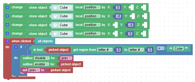

I have another question, how did you deal with selecting the duplicated object? I currently facing a problem if I duplicate an object, and I try to use “Picked Object” puzzle to select the second object. Sometimes it will select the first object instead because the component name is the same for duplicated object
2022-07-03 at 12:45 pm #53828kdv
Participanthow did you deal with selecting the duplicated object?
You mean cloned objects? Objects names can’t be the same, they always differ…
https://v3d.net/92uto select the second object. Sometimes it will select the first object instead
do not use x-ray in the
when clickedpuzzlePuzzles and JS coding. Fast and expensive.
