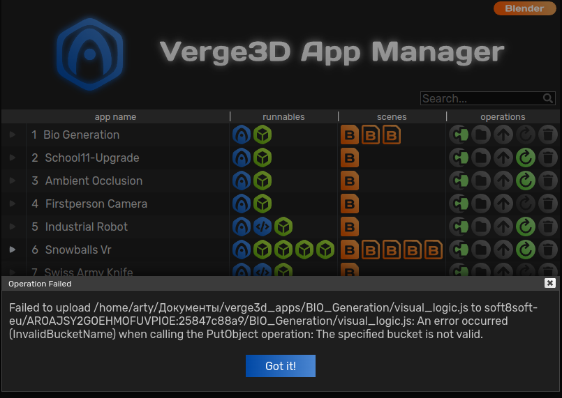

    Yesterday when trying to upload application on the verge server – Application Manager started to give such an error. Tried to delete puzzles (used only for comments), tried to download sample applications, and turn on VPN. The same error
    “Failed to upload /home/arty/Документы/verge3d_apps/BIO_Generation/visual_logic.js to soft8soft-eu/AROAJSY2GOEHMOFUVPIOE:25847c88a9/BIO_Generation/visual_logic.js: An error occurred (InvalidBucketName) when calling the PutObject operation: The specified bucket is not valid.”
    Verge ver 4.9.2

    #82518
    We just checked your AWS storage and it works just fine. It appears to be the issue with your internet connection, not the bug on the server side. Please try to upload via VPN/Proxy to see if it helps.
