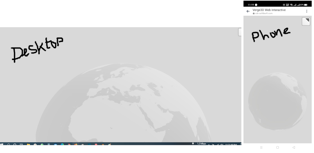

    I am creating a globe world. It supports desktops but does not support or run on mobile phones. It is important to support mobile, how can I get a solution? I shared the link.
    https://cdn.soft8soft.com/AROAJSY2GOEHMOFUVPIOE:bd8c4fcd7b/applications/Glob_Earth/Glob_Earth.html

    Seems like the image too big, try to use smaller for mobile phones, most of the phone not support bigger than 4k images.

    This, not a 4k texture. this 1200×675 pix.

    Thank you for your reply. Now supported on mobile phone but I need half of the camera view. I want to see the same on the desktop. Please tell me how to do it.

    Try t play with Sensor fit of the camera settings. Maybe horisontal type can help.
    Otherwise you will need to create two cameras one for desktop another for mobile and switch between them.

    Can you tell me how to switch? Like when opening in desktop or when open it mobile phone…

    Create two cameras, then directly on main puzzle desk create an If and Feature Available puzzles which will detect a mobile device and then according to that information will change camera from one to another.
