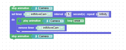

    The situation is as follows: I play a camera-animation that starts a while after loading the App so that the users get the idea that they can navigate the scene. It’s just a short back-and-forth rotation movement around the target.
    See the puzzle-screenshot attached.

    #4 The loop “once” does not work. I have to add a puzzle to stop the animation manually. What could be the cause?
    #5 The App allows to load other scenes. On return (reloading) of the initial scene the camera-animation suddenly plays in a loop. Is there a connection to problem #4?

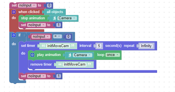

    #2 and #3 need some work. I try to check for any input by the user and tried “when clicked <-> all objects” to globally stop the camera-animation. I used it this way because my HTML overlay is not generally clickable so the user can navigate within the iFrame.
    Any idea where my logic fails? :unsure:

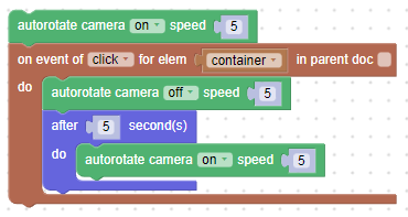

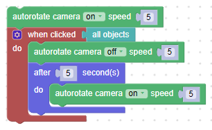

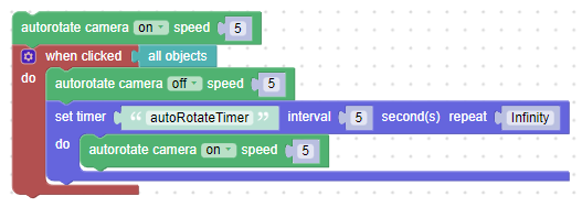

    if (!noInput) will be executed only once after the app loading…
    I see it this way
    or this way
    or this way (preferable)
