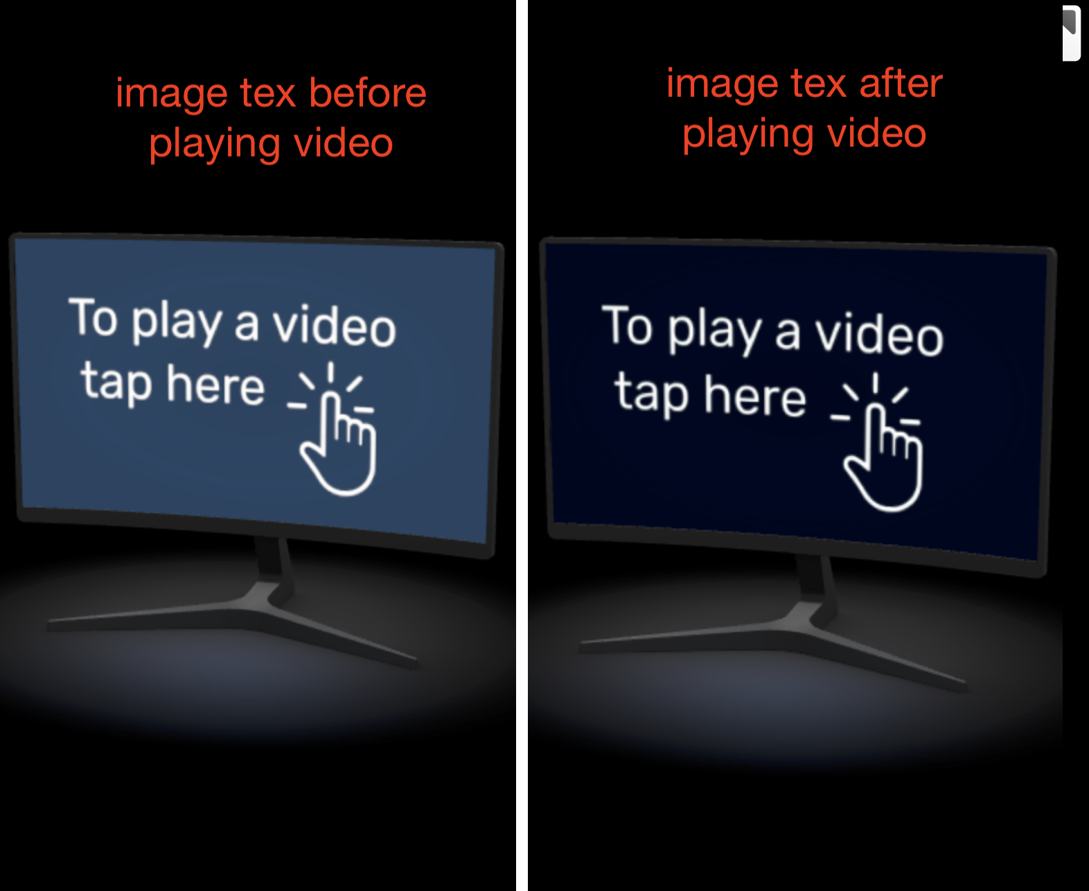

CustomerHi, I have found a strange effect happening when you play a movie as a texture: as in the demo file, i would like to start with an image texture, that gets replaced by a movie texture. so far all works perfectly. now i would like to switch back to the original image with new click (replace texture again with original file).
-> strangely the original file is now much darker, it looks like wrong gamma?i added a few lines to the “video texture” demo file to show the behaviour:

Participantwhat’s the reason for this behaviour?
The reason is inside the
replaceTexture()function. They apply a specific code to adjust the color space for video textures (otherwise they are too bright).
This code affects only node materials. So try to use a PBR material (aka glTF 2.0 compatible) for the
tv_screenobject. But keep in mind that glTF 2.0 compatible materials support only thePrinciple BSDFshader. TheEmissionshader is not supported. Or you can use a black-n-white texture to see no difference. Maybe it will help.Puzzles and JS coding. Fast and expensive.

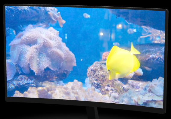

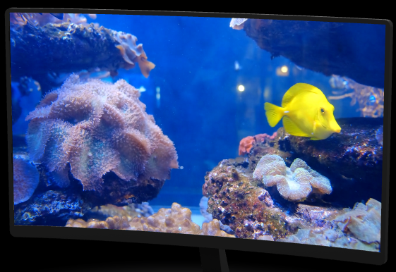

2023-09-11 at 8:51 am #66746stefanp
CustomerHi kdv thanks for the quick answer. the glTF solves the issue but it seems to only work properly with a non-emissive BSDF texture – so might not be the perfect solution for a screen as those are in principle emissive. I found a way to correct emissiveness in “set value of material” puzzle but it is very approximative, and the video looks less vivid.
maybe there could be an option box for the specific code so it can be removed after swapping texture again in future release?
in the meantime the best option I found is to add second image node as video placeholder and switch it with a value node. this way it can also be animated with a crossfade.
thanks, sp
