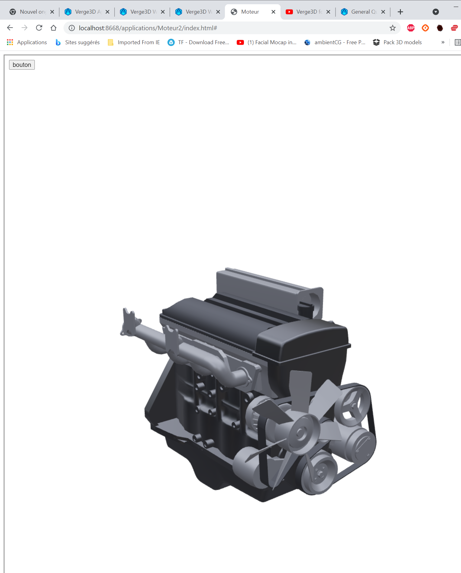

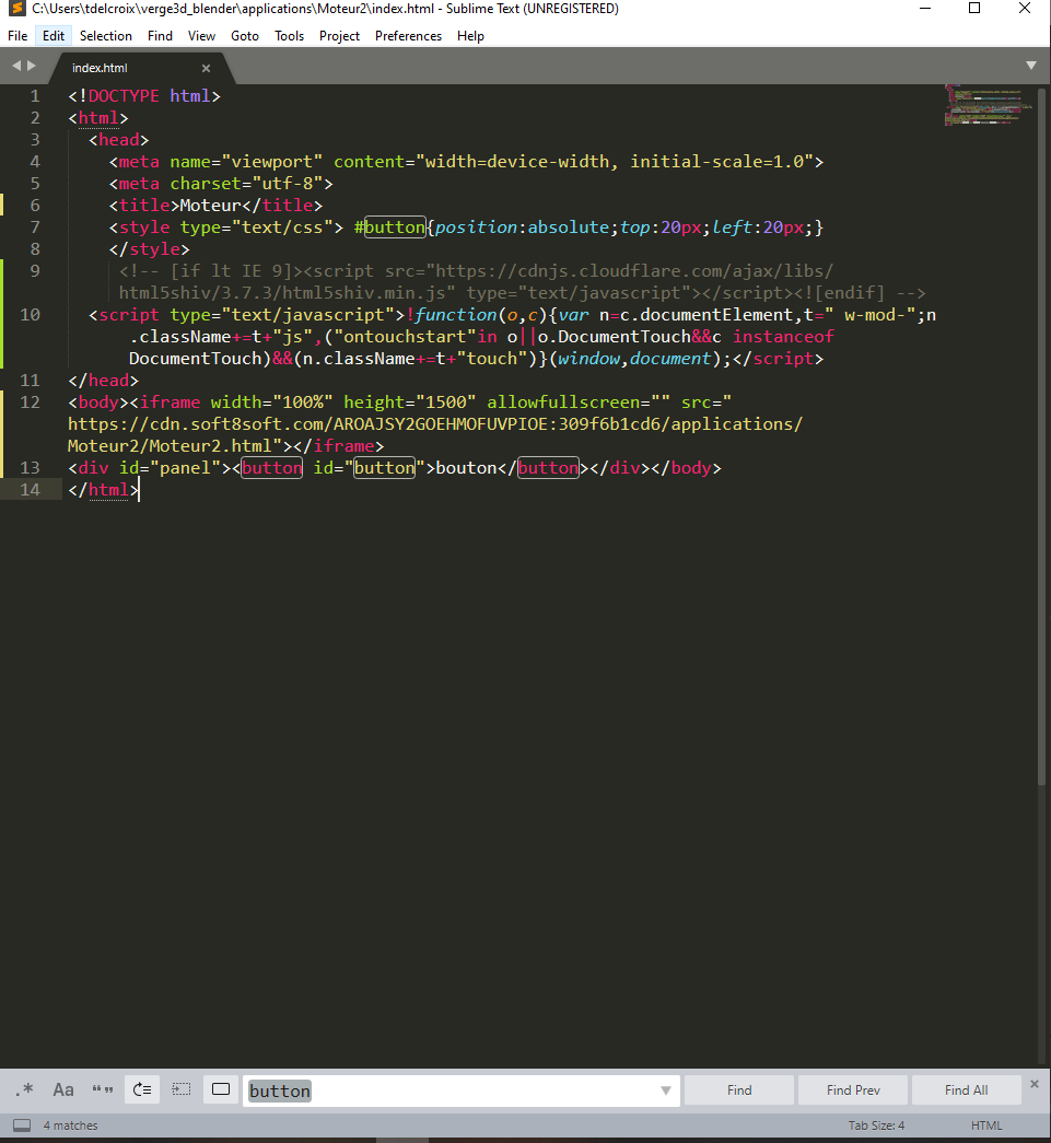

    Hello, I am new to verge and new to HTML programming, I followed the tutorial available on Youtube which shows how to switch from blender to verge but it does not work I attach a screen of my puzzle editor, my code html as well as the rendering on chrome, namely that my annotations are not visible and that my button does not work

    you’re using absolute path in the URL – it refers to Soft8Soft CDN, but the rest of the app is viewed locally. JavaScript is not allowed to work in cross-origin mode (security policy). You should use a relative path instead.
