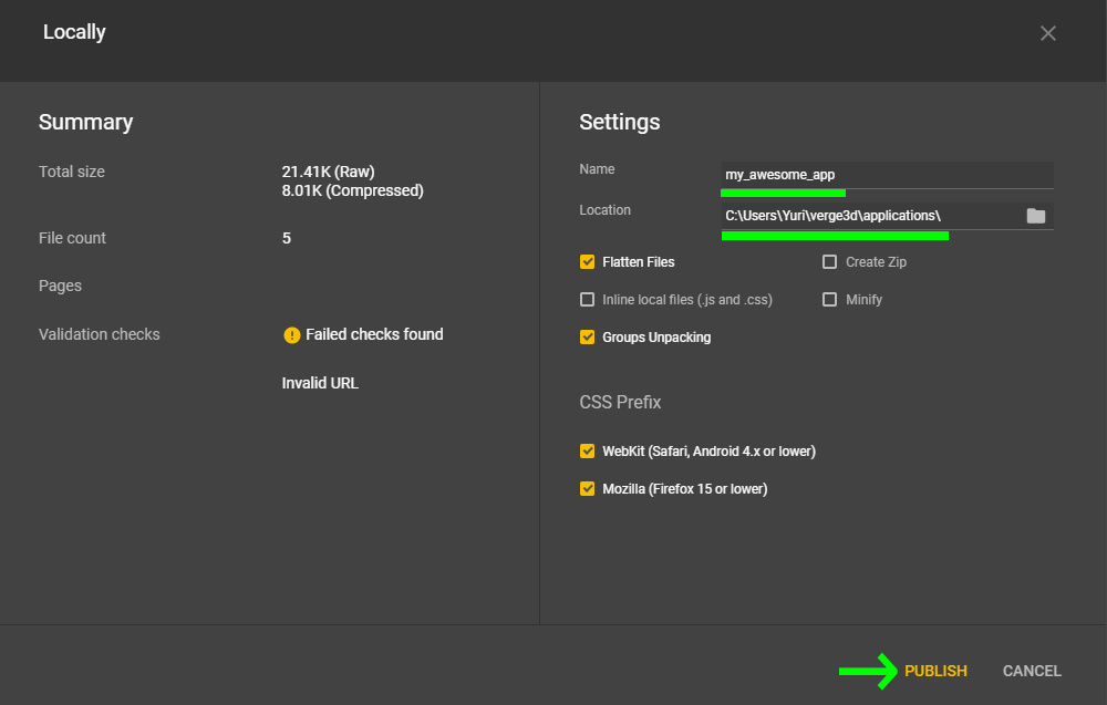

    I’m having trouble following the HTML UI tutorial in the manual.
    I’m using the Google Web Designer to build the interface, and have followed everything exactly. But when testing it out and clicking the 2nd blue icon in the app manager, I only see the UI and not the Verge3D content (cube and grey background). I only see my button and white background. I’m wondering what I missed?
    Check out my sketch book :) | www.instagram.com/b.potts.art/
    #11739
    This likely happened because of incorrect relative path specified by the iframe src attribute. When exporting from GWD, make sure you leave Name field blank. This should export it to the root of your app folder.
    You can also fix the path (or move the export folder to a correct location) manually.

    Ahhh, yes. Got it. Thank you!
    And your Youtube tutorial helped!
