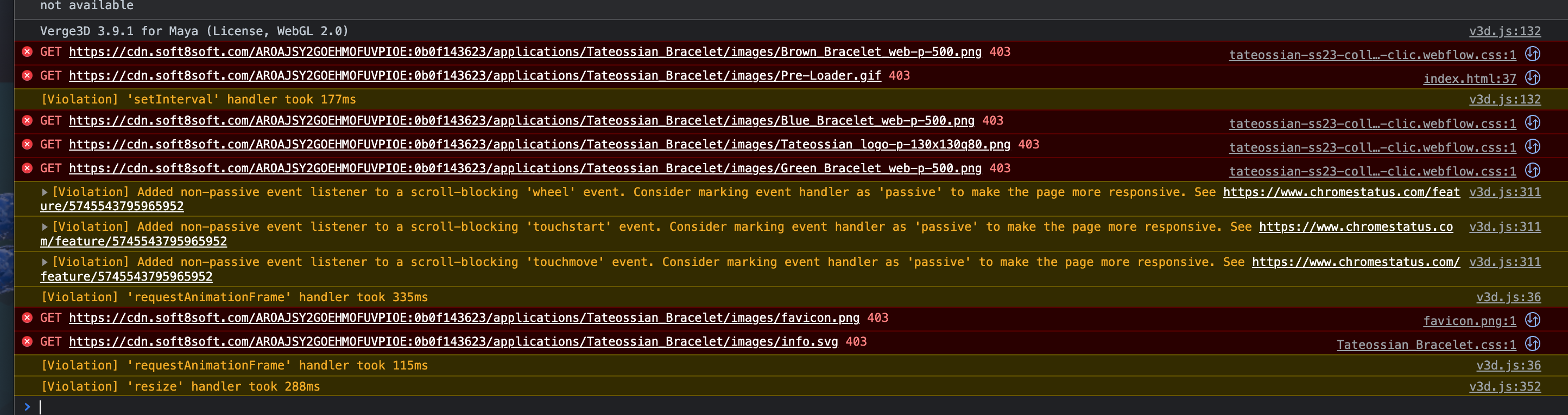

    #53678
    You will need to use some dev tools to monitor the console log. See attached image. Your assets are not being loaded. See 403 errors.
    #53680
    A little more digging and you will find that many of the file have cross origin problems. Meaning they are files that are trying to be access from another site. You will need to move those files locally then go through the CSS and make sure they are pointing to the local files.
