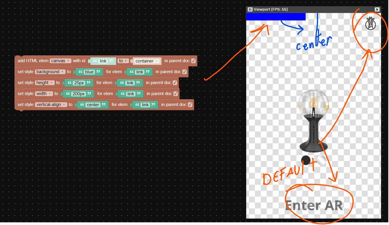

    I’m trying to make some buttons/ui for an app
    So my dog knows more about programing than I do so I tried something with puzzles and I somewhat got what I wanted except I’m struggling with the alignment of the element, (check image below)
    I have the blue button and I want to center it to the screen no matter the aspect ratio of the device used, like the buttons for AR and the top right of the screen there.
    Is there any way to center it with puzzles?

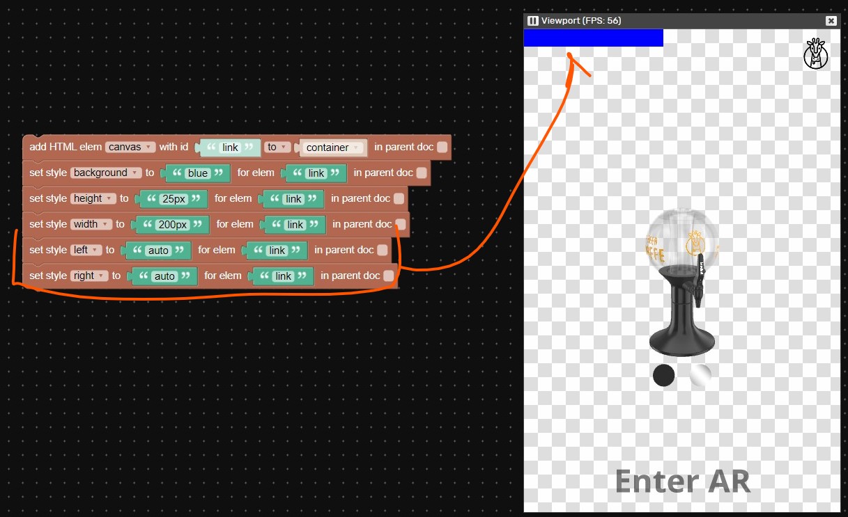

    set style properties left and right to auto.

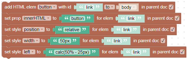

    #57145
    try this

    andrei pek
    It didn’t do anything, nothing appeared.
