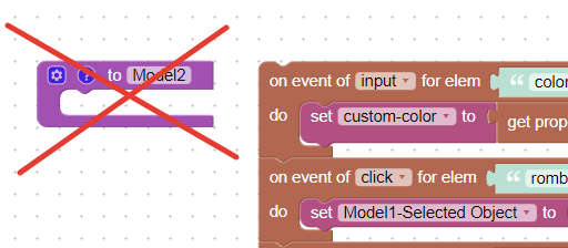

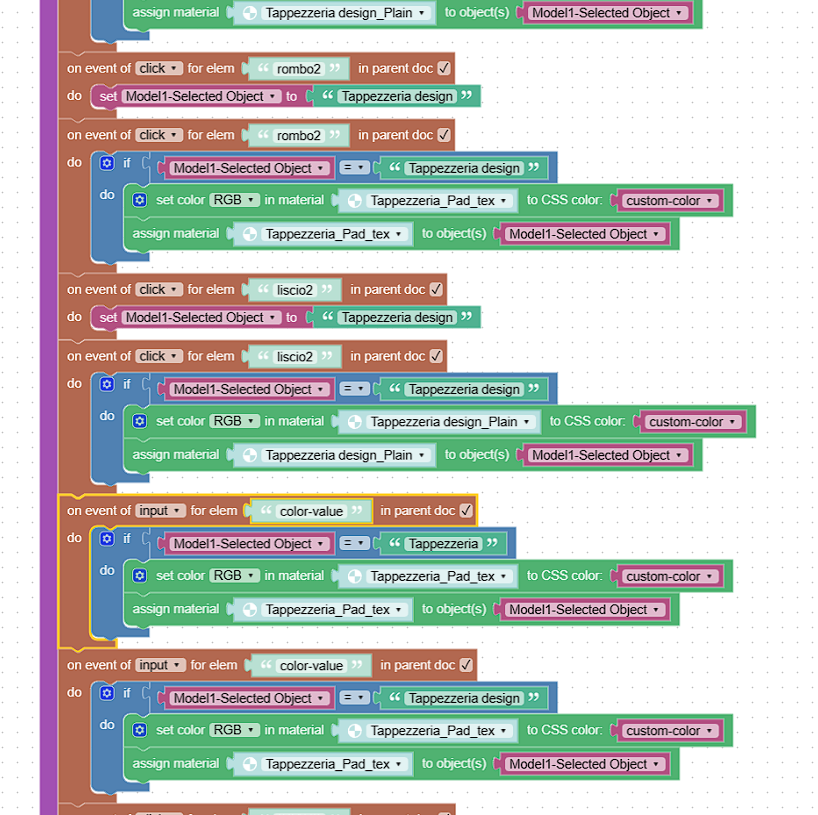

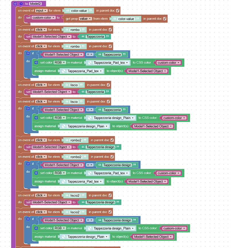

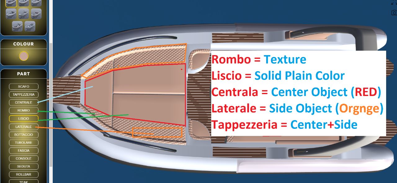

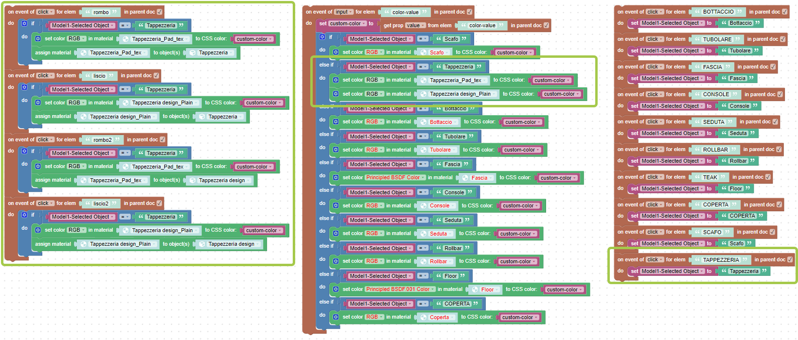

    Teppezzeria button combined “Centrala” and “Laterala” . Centerala have two buttons “Rombo” ( Square texture) and “Liscio” ( Solid color).When I click the “centerala” button it shows the “rombo” and “liscio” buttons. Then when I click the “rombo” button it’s showing a square texture and when I click the “Liscio” button it’s showing a solid plain color. At the top, you can see the color option. This color doesn’t work Rambo and Liscio group of the “central” and “laterala”

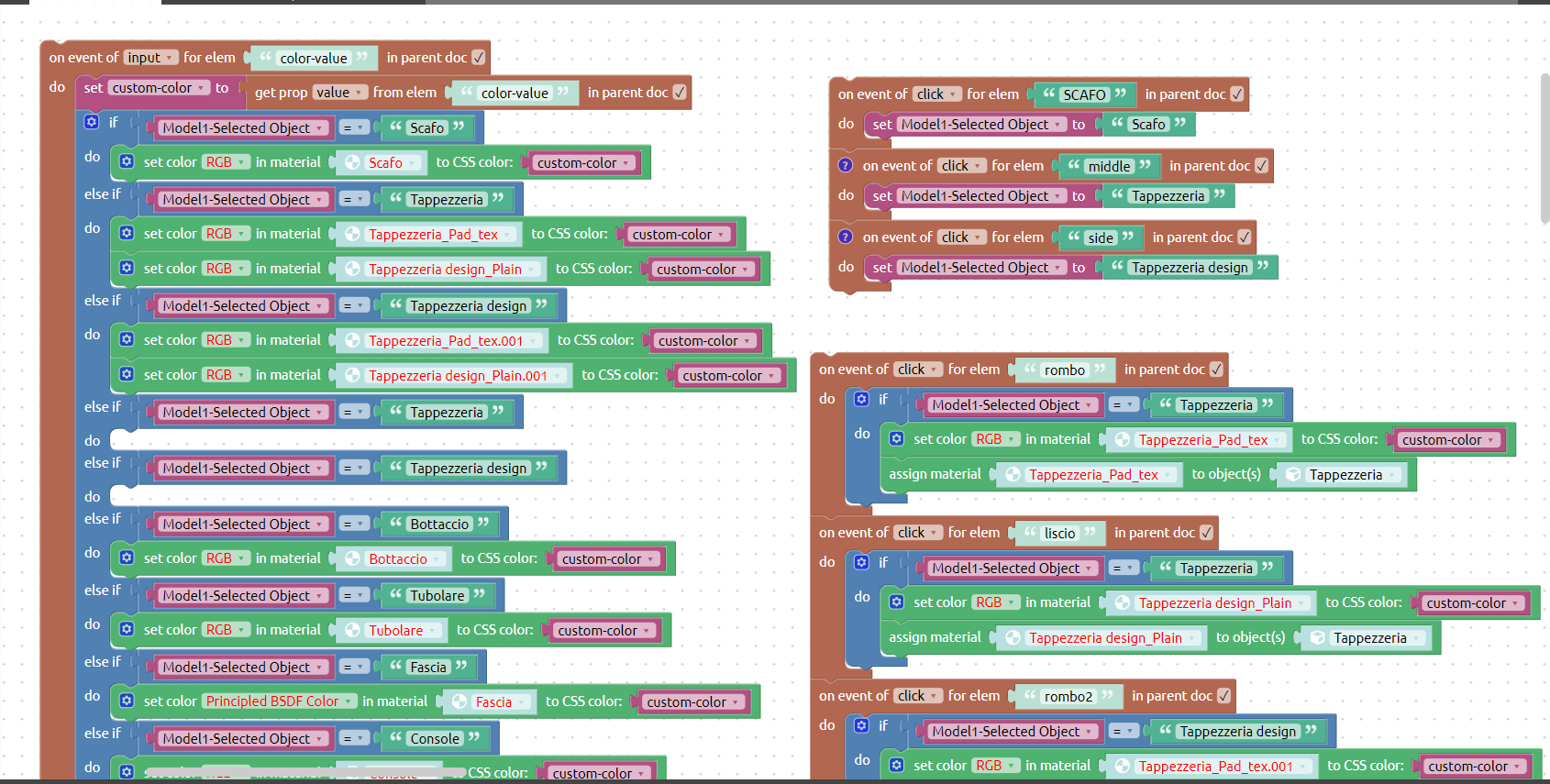

    Here is this file.

    Too many unneeded duplicated event listeners and wrong logic…

    I don’t know, how I give you thanks. Although this task the client no longer took delivery, only putting so much effort into my learning. One worked really well although I had to fix some issues. The RGB colors weren’t working properly, so I had to create two extra materials from the 3D model and set up the puzzle again. After that, it works very well. Thank you very much.
