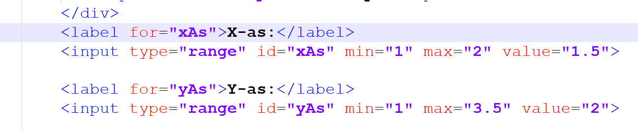

    im quite new to verge3d, ive made a slider in html like this:
    I would like to use it to drive a puzzle variable, ive tried to do it like this:
    What am I doing wrong? any help is appreciated.

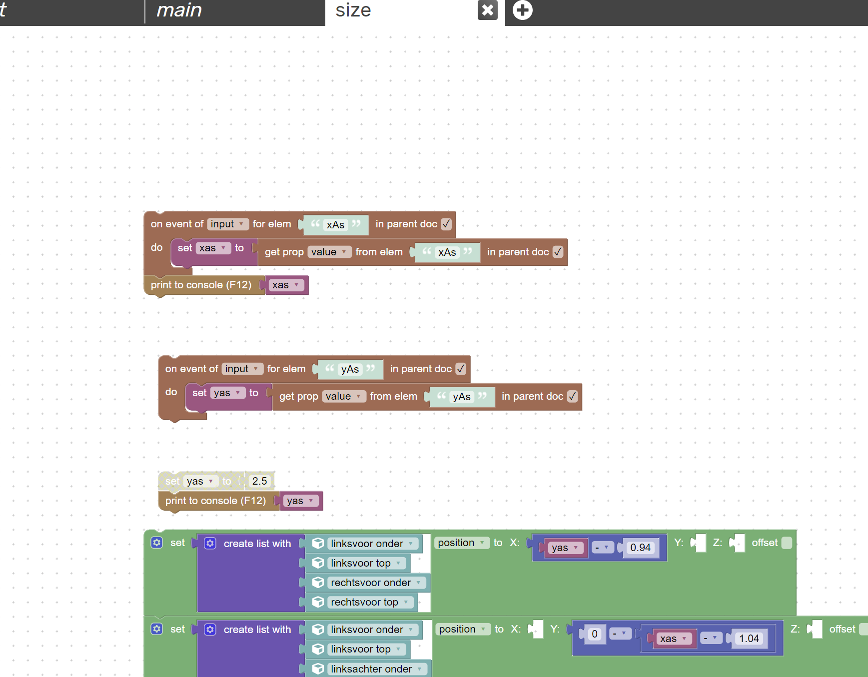

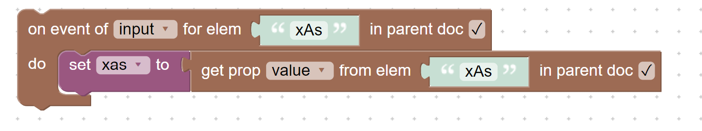

    4. Where in your puzzles did you put the print console puzzle? Is it after your set variable?
    #76507
    thierry

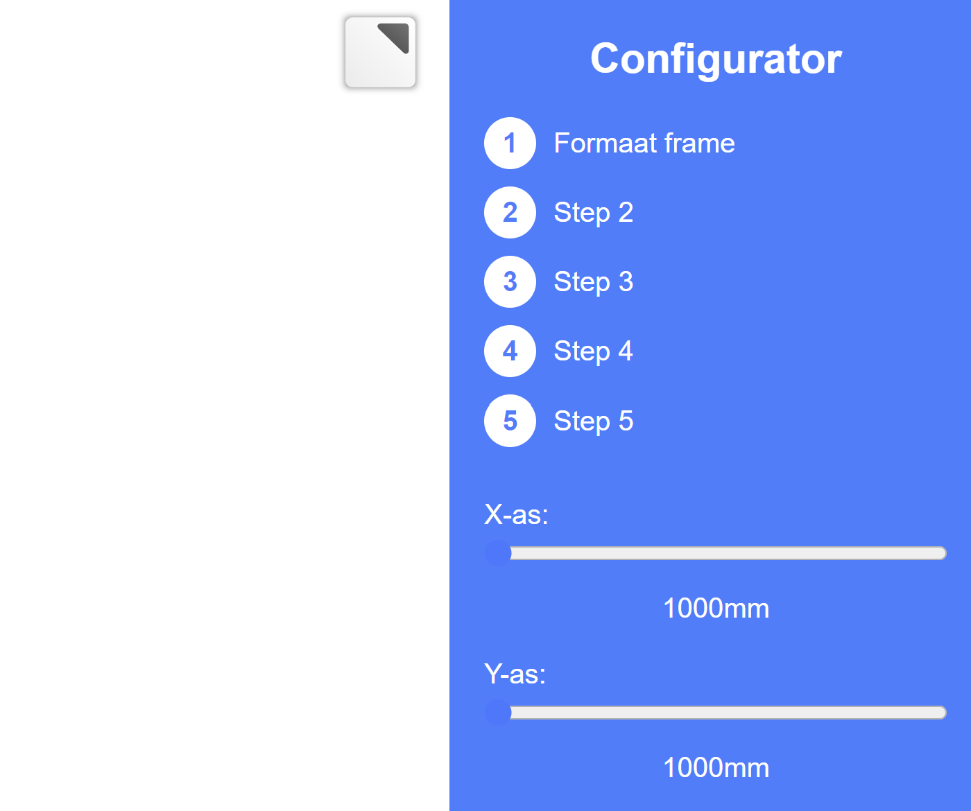

    1. the slider does appear, picture attached.
    2. the slider is in index.html which I made as a site ui, the buttons in the same file do work.
    3. im not sure, iframe is also implemented in index.html.
    4. picture attached
    I could share the project, im unsure how to.
    thank you for the help!

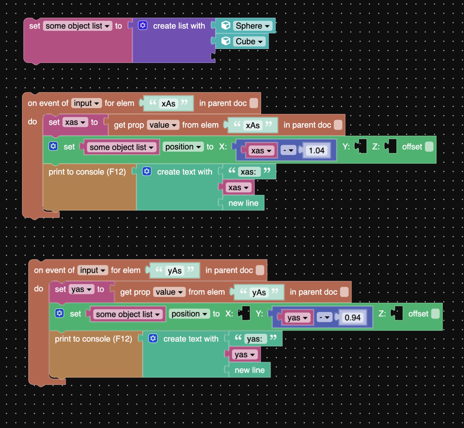

    Ok…so attached is a image that will help you with what you need and get it working. What I mean by that is the information will appear in the console and it should move the associated objects in the list.
    The issue is how you have laid out the puzzles. In your example the print to console commands are outside of the event input puzzles…so it will only give you the value at the start of the applicaiton. To make it give you the data you need it has to be inside the event input puzzle. This also is true for the set object position puzzles. They currently do not have any reason to execute other than on initial load.
    Hope this helps.
