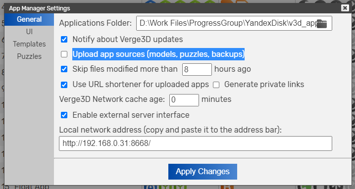

2023-11-30 at 1:33 pm #68909kdv
Participantexports EVERYTHING including the Blender and V3d backend files.
Disable uploading for app sources:
2023-11-30 at 2:14 pm #68912
PLAN8CustomerHi,
I believe that only works for uploading to the V3D server? I don’t think that applies for local export? Might be wrong!
2023-11-30 at 2:18 pm #68913
PLAN8CustomerI just tested that, the export to local zip file doesn’t respect that option – all files are included in the zip file
