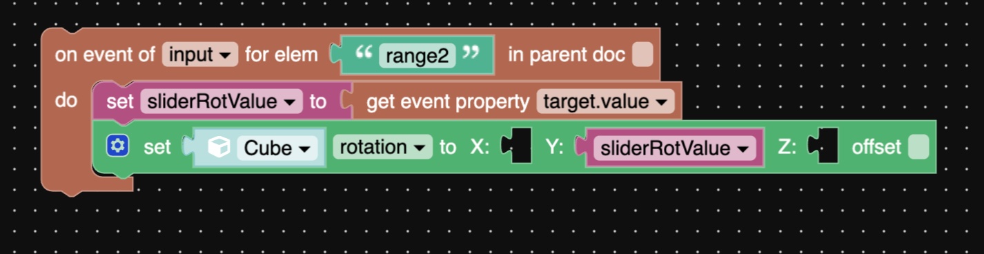

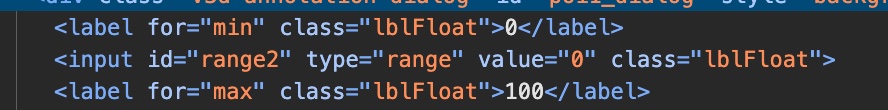

xeonCustomerHi domjasper….i take it my last bit of information was not sufficient.
Here is a screen shot of the HTML for the slider and the puzzles needed to read it into a variable and make an object move…no apply button needed.Attachments:

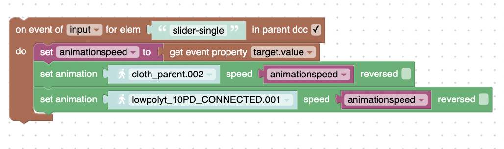

CustomerUnfortunately no success. Attached screenshot of puzzles.
Here is the slider code:
