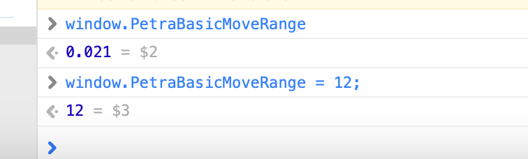

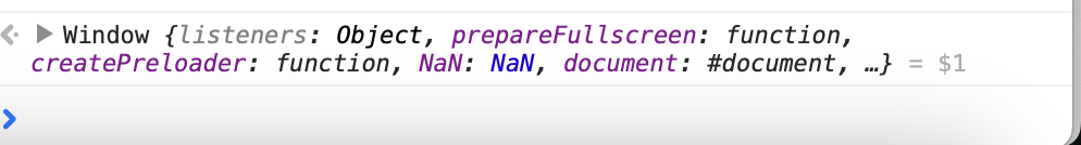

    #82955
    bigmike814
    No, you are just referencing the set value not setting it. If you want to be able to reference or set values outside the v3d environment use the window and set it as an object.
    Open your console and type window and hit enter. It will give you an object with a bunch of other object. You want to set your object to the window if you want to use it cross platform.
    I’d recommend naming objects, functions and setters (variables) using camel case so you can keep your internal window objects separate.
    Now you can reference the value using window.PetraBasicMoveRange and if you want to change the value with an external function you can window.PetraBasicMoveRange = 12;
    and it will set the value.

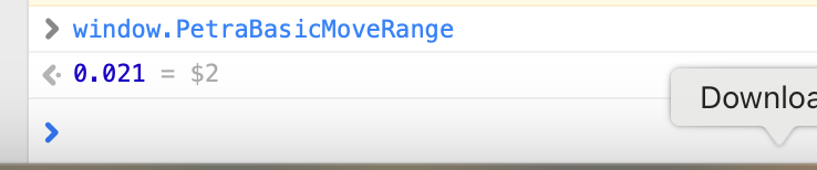

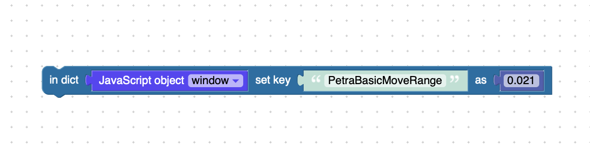

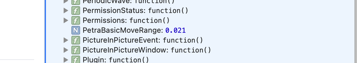

    #82960
    bigmike814
    here are some more screenshots. You’re already referencing the window, but it you want to set values externally, the window is the best way. Also, if you get in the habit of using objects globally, your life will be much simpler.
