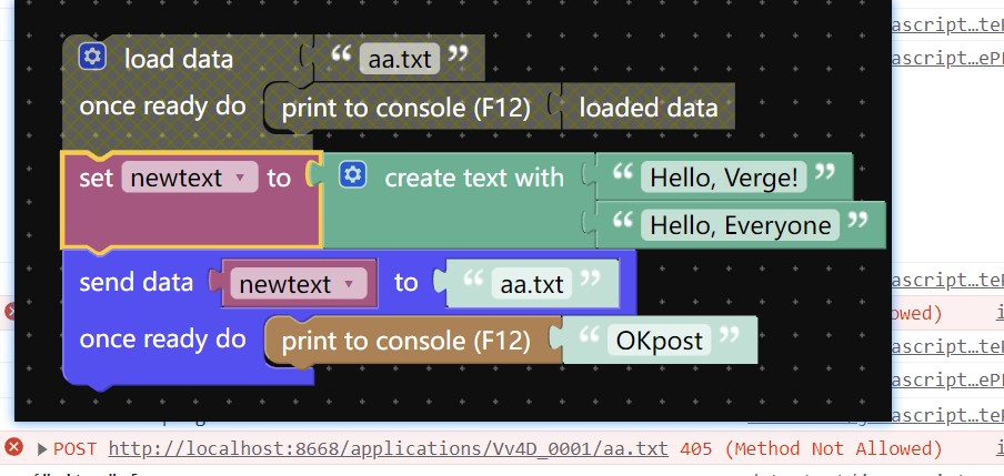

aqiangCustomer“The ‘load data’ puzzle supports GET requests to the local server, while ‘send data’ does not support POST requests to the local server. Without creating a custom server, can the current server be made to support POST requests? Any advice is appreciated. Thank you.”
2023-09-25 at 12:01 pm #67105
Yuri KovelenovStaffHi,
the local server is mostly intended to run the App Manager, not to handle requests from an application. On the other hand, the send data puzzle can be used precisely for that, for example, coupled with the WordPress plugin.

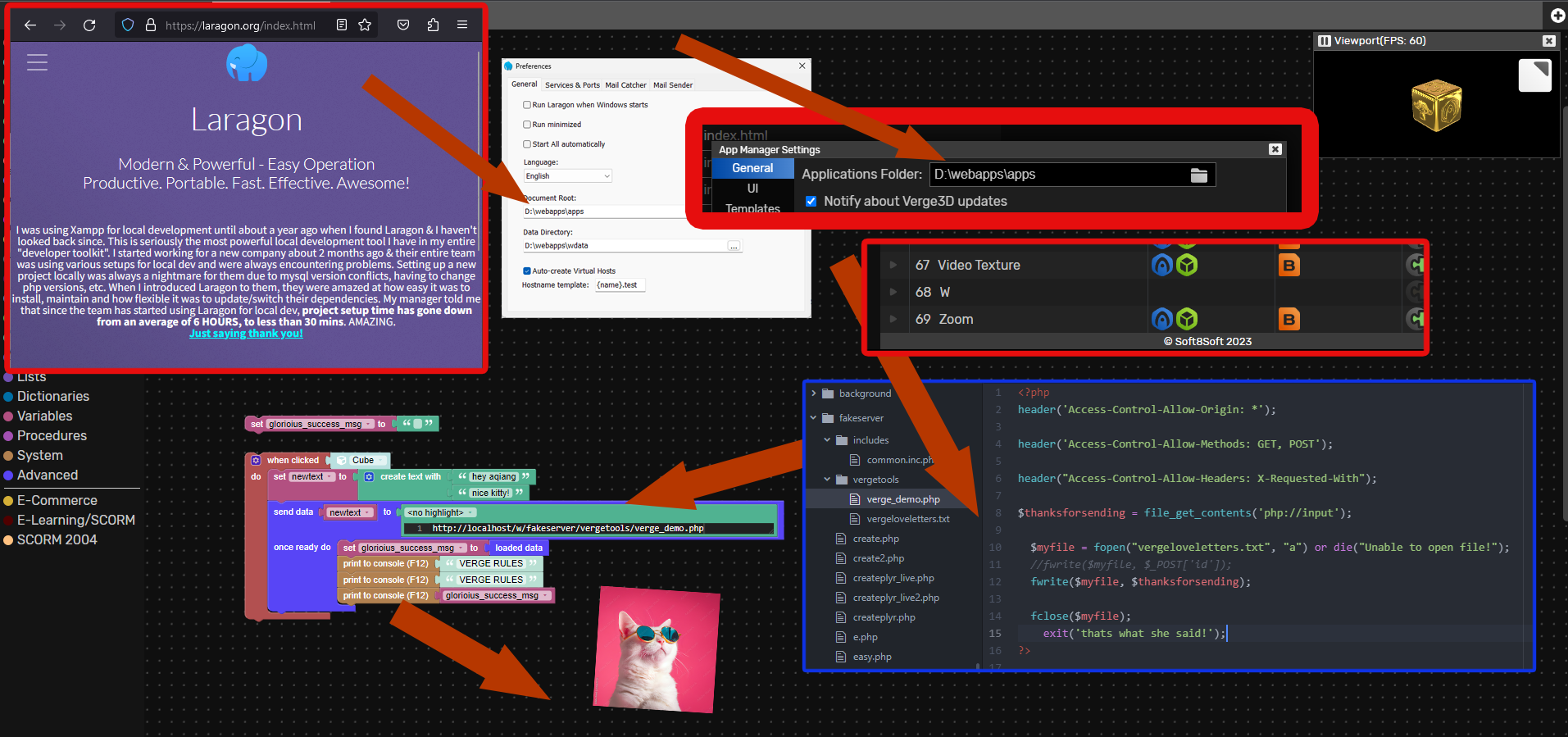

CrunchCustomerYes you can do it all locally. I am setup with Laragon (I highly recommended getting Laragon for your local server…. its a dream compared to xxamp.
I got things configured so I run Laragon at the same time out of the same dir as Verge and its pretty slick. I can share my setup with you but won’t have time to get this until next week.
Sorry to tease. But i know for sure I got it all working with the standard send data puzzle.
2023-09-26 at 11:20 am #67122
CrunchCustomerOk, here is my sweet setup. When a job calls for server stuff, I run Laragon along side Verge and have the default directory pointed to same directory as my verge apps. The sub folder I put all my php server stuff is labeled “W”… which of course shows up in Verge manager as an app but we all know its really not an app.
Create a php file to receive the output of your post puzzle, easy cheezy

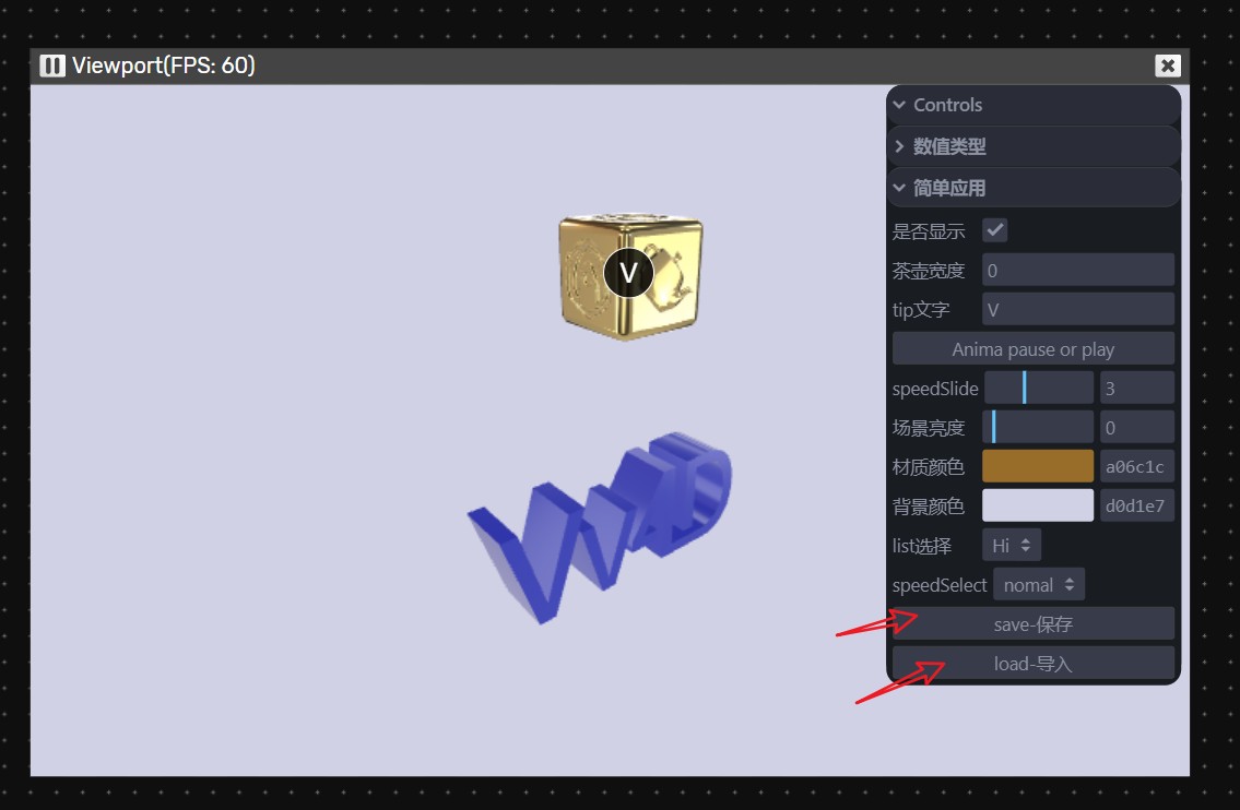

aqiangCustomerYuri,Crunch,Thank you for your responses. It’s possible that my previous description wasn’t accurate, which led to answers that didn’t address my actual issue. My idea was to create a custom control panel similar to dat.gui, and I wanted a ‘Save’ button to store the panel’s data in a local JSON file. However, your suggestions have opened up new possibilities, and I eventually found the simplest solution to be saving the data to the browser’s localStorage. Thanks!

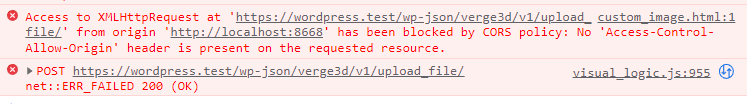

2024-01-23 at 6:24 am #69880kdv
ParticipantThere is an issue with uploading:
These links are not working when the
Permalinksoption (in WordPress settings) is set toPlain. But they are working withPost name.Puzzles and JS coding. Fast and expensive.
