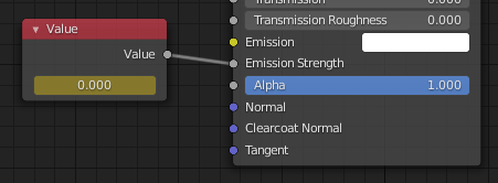

    #55534
    Just add the Value node and animate its value in Blender
    https://v3d.net/ajo

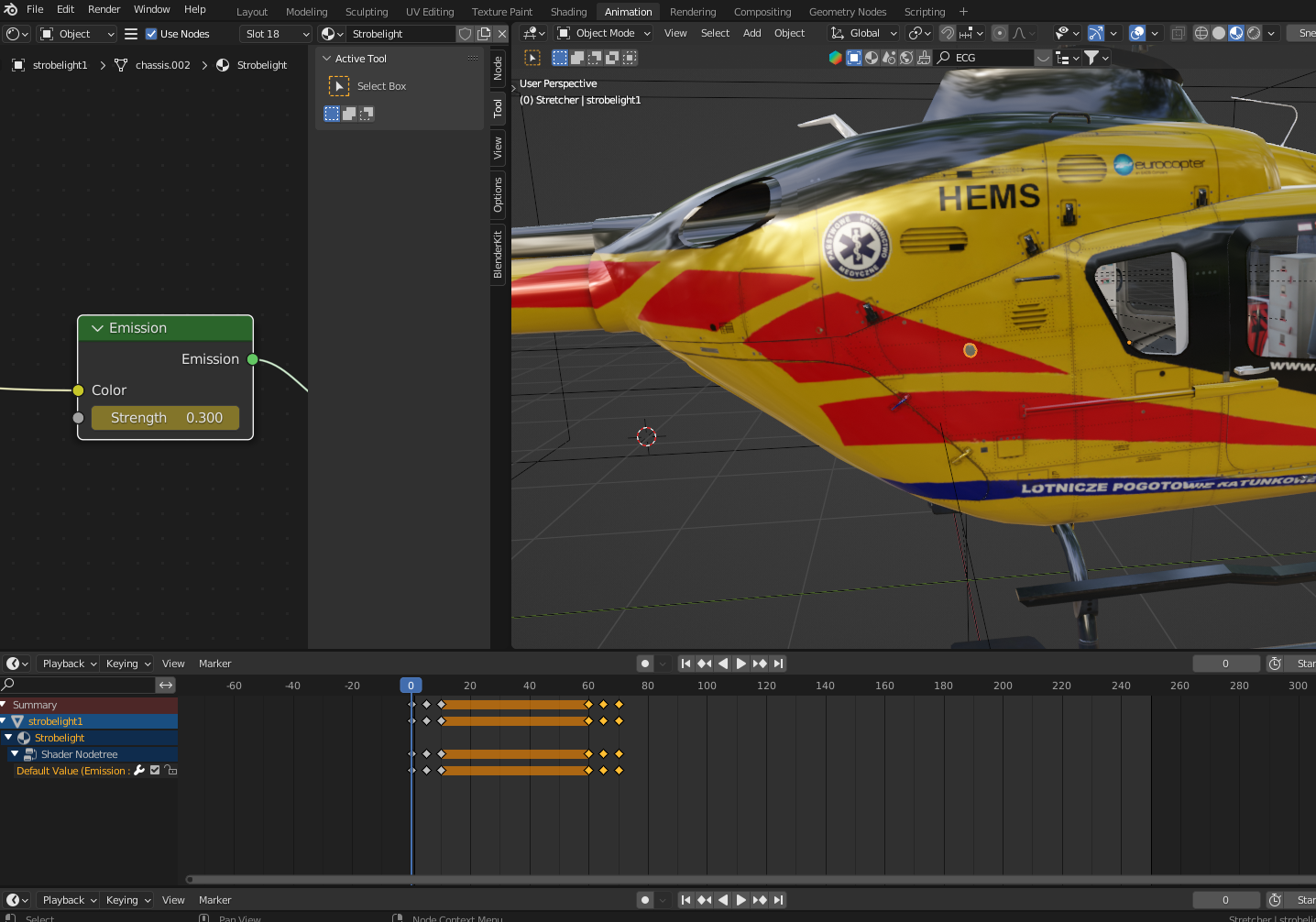

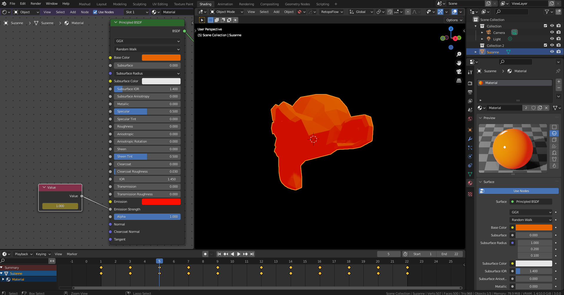

    mashud008
    @Gordon Thielsch.
    You need to keyframe light animation. I add a picture and blend file. You can understand
    Mashud Rana
    3D Modeller | Rendering & Interactive Expert
    www.rana3d.com
    #55539
    Gordon Thielsch
    Finaly it works! Thanks a lot !! :yahoo: :mail:
