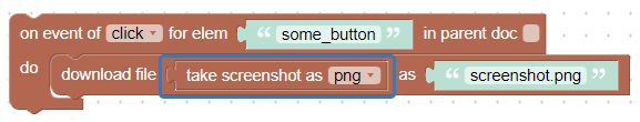

What option do you mean? Actually, nothing will appear after enabling this option. It just allows to take a snapshot from the v3d canvas without html elements over it. Enabling that aption allows to use this set of puzzles to take a screenshot:
Most likely it won’t work in the AR mode.In iOS it is possible to make screenshots in AR.
In iOS in the AR mode the app’s logic is not used. At all. Absolutely.
