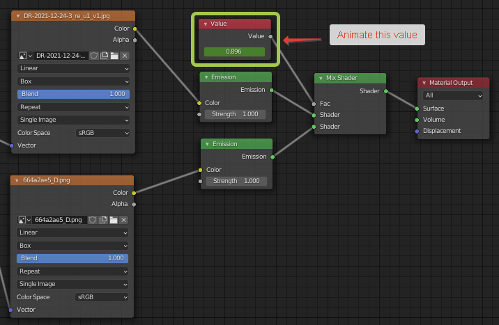

2023-11-12 at 10:14 am #68436kdv
ParticipantUse
Mix ShaderorMix Colors(it doesn’t much matter)
You just need to animate
Facfrom 0 to 1 or from 1 to 0 after replacing one of two textures. The point is to replace the “invisible” texture and animate the mix factor from the current texture to the new one.Something like that https://v3d.net/q0m

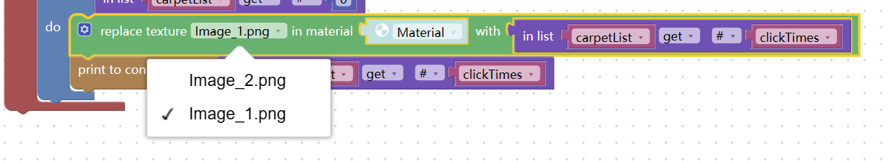

2023-11-13 at 1:47 am #68443guoyong0318
ParticipantThanks for your reply, but I have more than 2 textures and I want to change textures in the runtime, for example, when animating mix from 0 to 1, texture01 will be covered by texture02 then I want to replace texture01 with texture03, so I can animate mix from 1 to 0 to show texture03.

2023-11-13 at 2:29 am #68445kdv
Participantwhen animating mix from 0 to 1, texture01 will be covered by texture02 then I want to replace texture01 with texture03, so I can animate mix from 1 to 0 to show texture03.
So, what’s the problem? Read
Value, use logic and animateValueaccording to its current state. If 0 – replace the second texture and animateValuefrom 0 to 1, else replace the first texture and animateValuefrom 1 to 0.BTW, I can’t use multiple mix nodes in Blender
There’s no need in it. It’s possible to cycle through several textures using only one Mix node (in that demo I used a list of three textures).

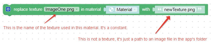

2023-11-13 at 5:24 am #68456guoyong0318
Participantyes, I can replace texture01 with texture03, but it looks like the texture01 in the replace texture node is not a variable, so I can‘t replace texture03 with texture05
2023-11-13 at 5:27 am #68458kdv
ParticipantNames of textures in your material won’t change. It will be always “texture01” and “texture02” after each replacing. Only image data is changed, names remain the same.
