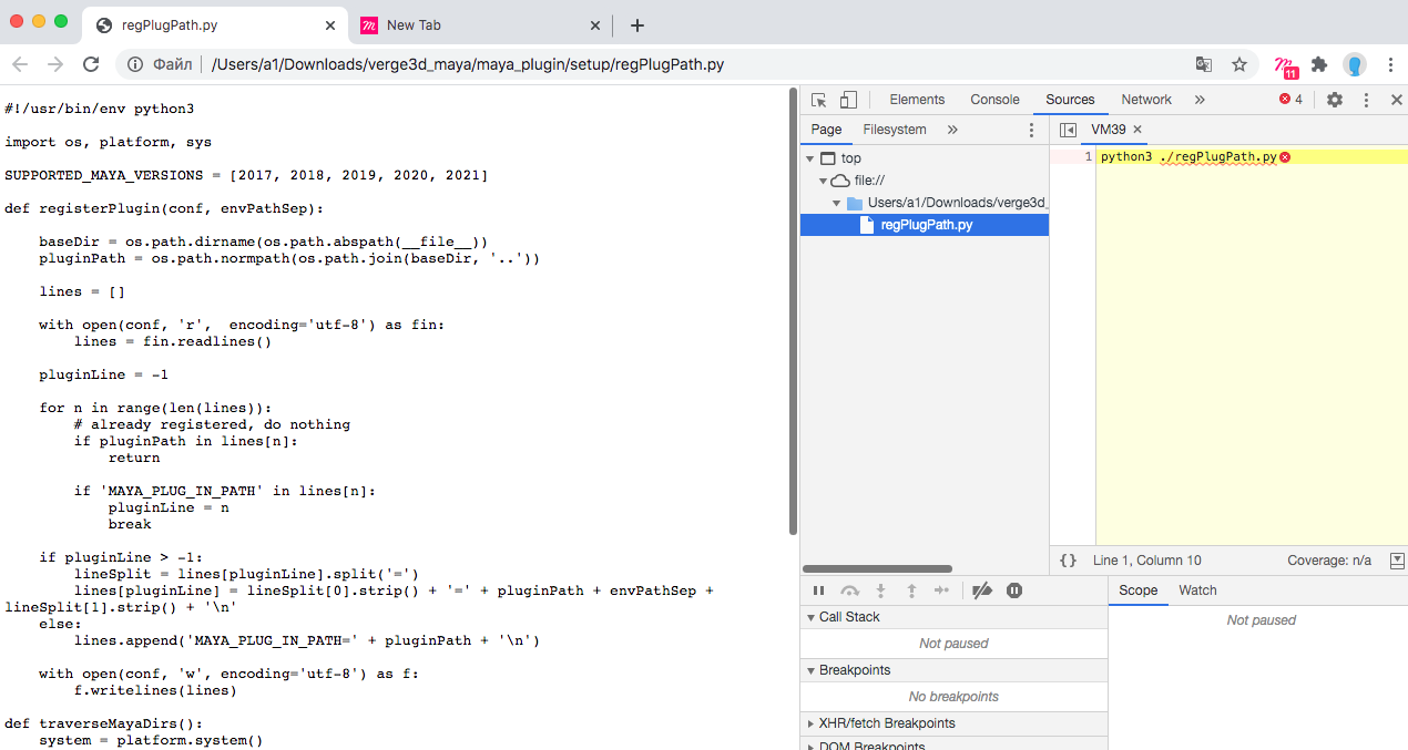

    How can I launch that script? regPlugPath.py
    I was trying in Chrome
    but i couldn’t, look scrin
    How can I launch the script regPlugPath.py?
    waiting for you answers..
    thanks for help)
    i used Console in Chrome
    #37256
    FunJoy.Tech
    Just drag the regPlugPath.py into the Terminal window, then press enter.

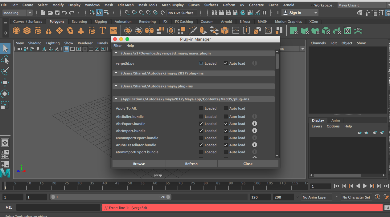

    hm
    now another trouble
    i can’t enable “Loaded”
    #37271
    ilzh
    can’t check box this box
    what should i do? :wacko:
    #37274
    ilzh
    // Error: line 1: (verge3d)
    #37275
    ilzh
    before in terminal
    MacBook-Pro-Mas:~ a1$ /Users/a1/Downloads/verge3d_maya/maya_plugin/setup/regPlugPath.py
    Registering plugin path for Maya 2017
    Registering plugin path for Maya 2018
    i have 2017
