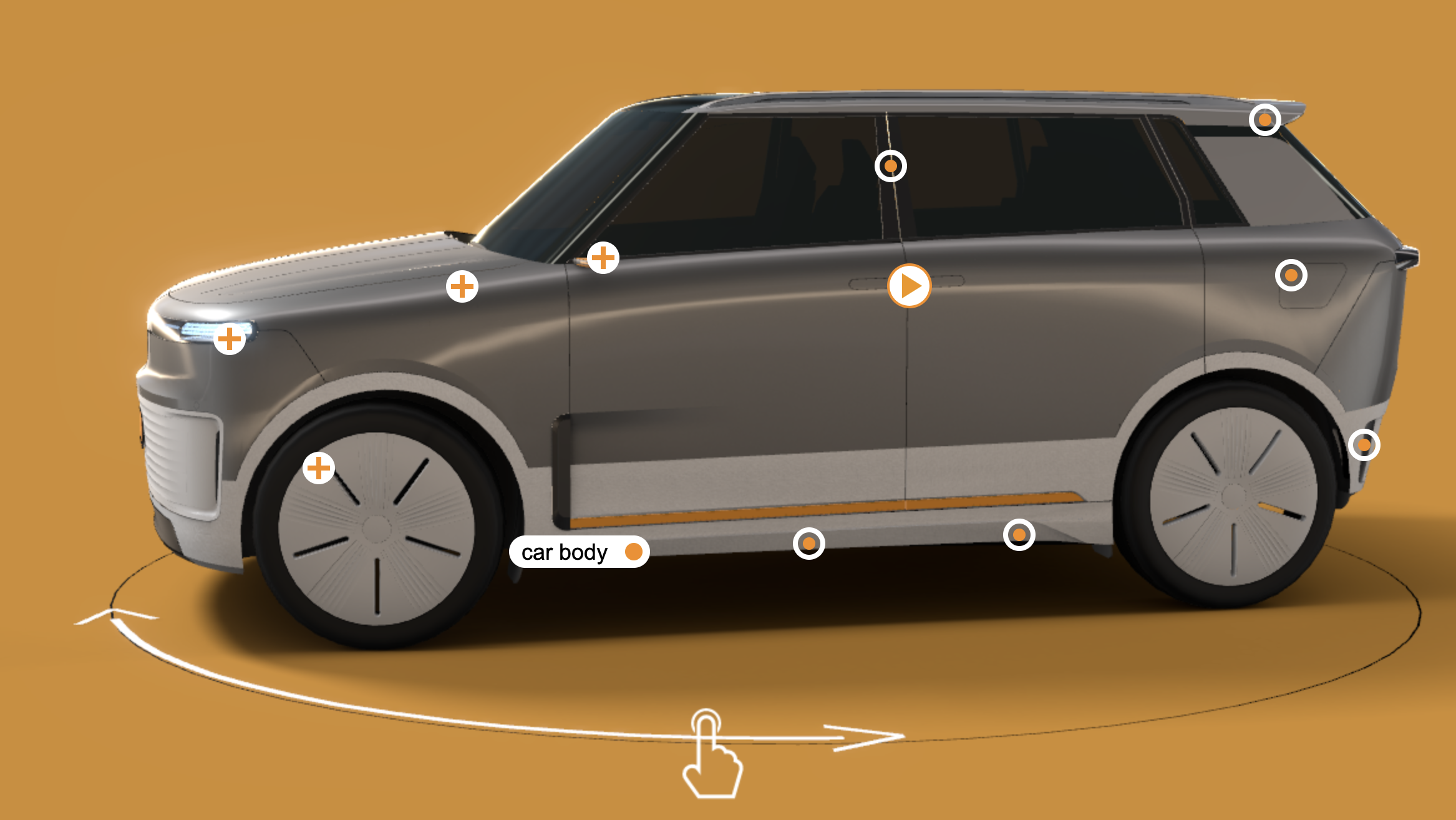

    Not sure if I got it right.
    Is is possible to add links and text to the annotation?
    I would like to use hotspot like on attached picture.
    Is it annotation used?

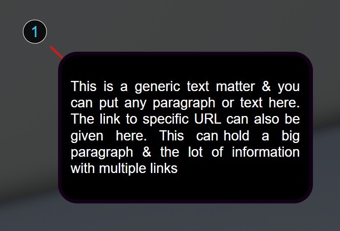

    #64064
    visualizer
    Hi
    You can very well add a text or even paragraph with any hyperlinks inside the text content when using annotations.
    Check the screenshot.
    Hope this helps.

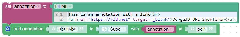

    #64066
    Yes
    https://v3d.net/9cj
