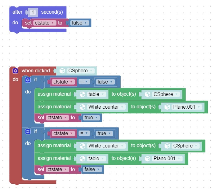

MicdsnCustomerI’ve tried several ways and can’t seem to reliably swap textures when clicking an object in the scene.
I’ve even tried GLIFTEKs object plugin and cant seem to get it. Like the simple configurator demo scene, BUT instead of several textured objects to copy, I want to swap the texture. ‘when you click A, B and A swap textures’– and you can do this over and over. Please advise.

GLiFTeKCustomerCould you show a screen shot of the puzzles you’re using?
plz share Discord link & on your signature!2022-03-21 at 7:37 pm #50464
MicdsnCustomerHere is a screenshot.. Not working. :(
2022-03-21 at 9:14 pm #50466
GLiFTeKCustomerTry it without the time puzzle.
Also, possible you need an intermediate hidden object to pass the replaced texture to before resigning it?
plz share Discord link & on your signature!2022-03-21 at 9:23 pm #50467
MicdsnCustomerI tried it without the time puzzle. no luck. I just tried an intermediary object to transition between changes — still not working.
2022-03-21 at 9:34 pm #50470
MicdsnCustomerIm using the new 4.0 pre2 .. maybe it is a bug?
2022-03-22 at 4:37 pm #50518
MicdsnCustomerUpdate: I resolved it, it was several issues. First one of the materials was pretty complex and would not apply to the object (it turned black). I simplified it and it worked. Second, the swapping seemed to delete materials that were swapped from the object. I had to have existing in the scene another object that had the same texture, without swapping anything. done! THanks for looking into it!
