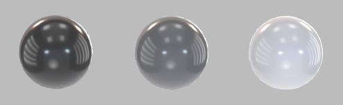

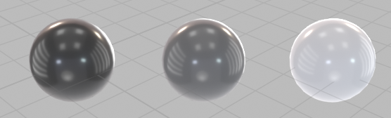

    Hello,
    Does anybody know how to create a glass sphere (no refraction, i know) using USD shaders within 3dsmax ?
    I need it to mimic the physical one i got here (see attached).
    I need USD for iOS AR stuff.
    #60183
    They don’t look like glass. Nearly zero roughness, ~0.5 metallness, no transparency. Just spheres with the mirror surface. So what’s the problem? USD materials have no these parameters?
    #60184
    NaxosCG
    They look enough like glass for real time purpose. When we turn around we get sort of a refraction effect.
    I just whant to get there but with USD shader.
    The purpose of this thread was to get some help.

    And it was a kind of help ))) Certainly, it’s enough and all you need are roughness/metalness/color. And I’m sure the USD shader supports those parameters. The transmission parameter is not supported, so you may forget about it if you are planning to use AR in Safari…
