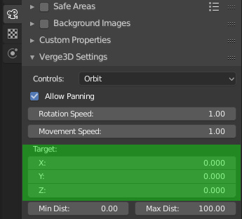

Yuri KovelenovStaffRegarding the other question, the camera looks down because its target is set to the look at the origin. You can modify the target coordinates on this panel:
