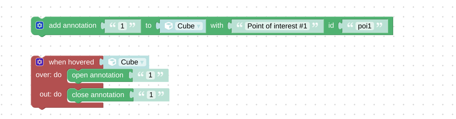

    If you need to open/close when the mouse cursor is over some 3D object, you might use the “when hovered” puzzle:

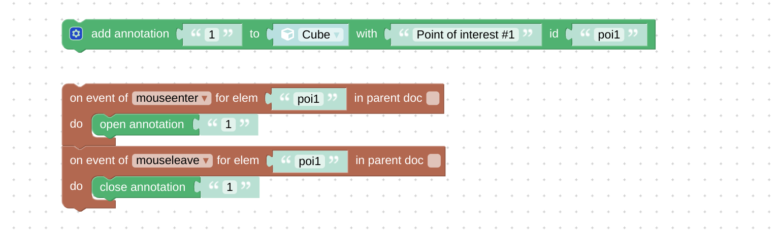

    In case if the hovering happens above the annotation element, use the “mouseenter”/”mouseleave” event handlers:
