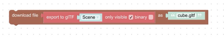

Hello everyone,
I was wondering, is it possible to export (download) your altered object with texture materials?
I’ve used puzzle to download>export_to_gltf puzzle, but I get only white material in object after I open it in 3D Viewer.
Does anyone know how to fix it, or can explain me what I’m doing wrong.
Thank you.
You must be logged in to view attached files.2022-12-02 at 6:42 am #58795Mikhail LuzyaninStaffAll materials must be gltf2.0-compatible to export them to gltf from app. Look at this part of doc.
