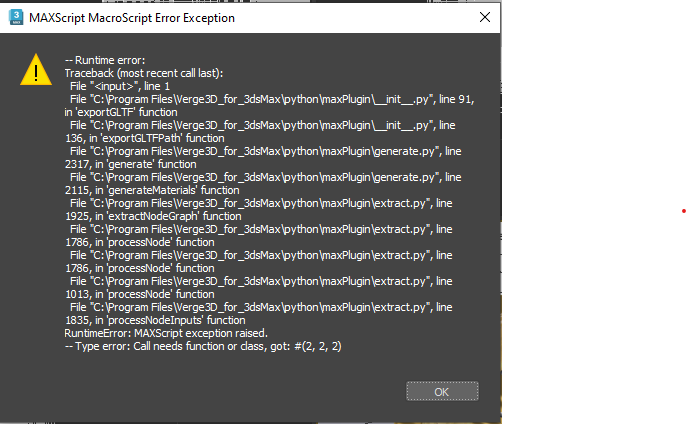

    #67038
    awais8845
    hey guys
    i got this error and have no idea ho to fix it
