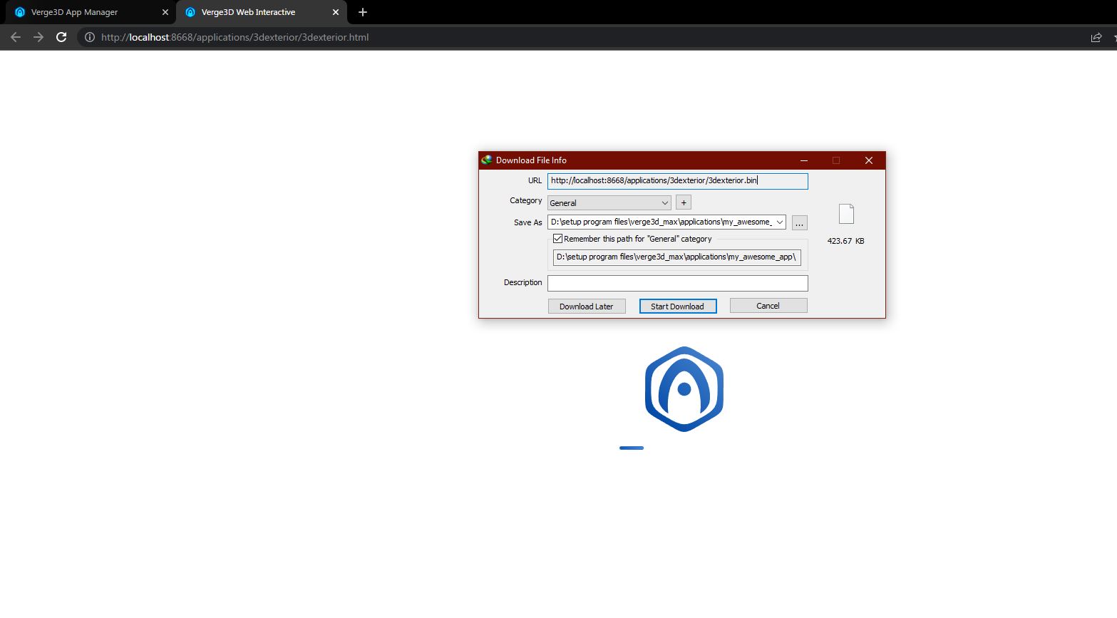

    Whenever I try to export the gLTF file and open the scene through sneak peek or app manager it will appear like that.

    what browser do you use?
    #52285
    nasreddine
    Google chrome
    #52296
    Google chrome
    looks like you use a download manager (google chrome download window looks different). deactivate it and try again. or customize your DM properly to ignore *.bin files…
    #52485
    nasreddine
    Thank you so much
    Finally, it works :yahoo:
