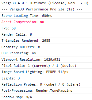

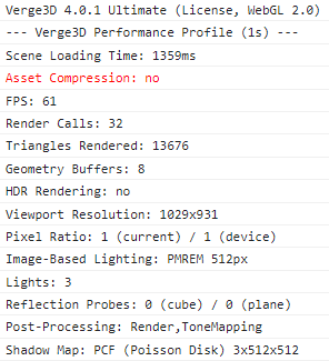

    Is this normal or an issue? Every light source casting shadows adds significant amount of rendered triangles and render calls. Three light sources multiply the initial amount by 4…
    CPU usage also increases…
    Solving any problems with Puzzles or JS code. Fast and expensive.
    #53739
    Yup, normal. Which is why I recommend to everyone not to use lights if they can.
