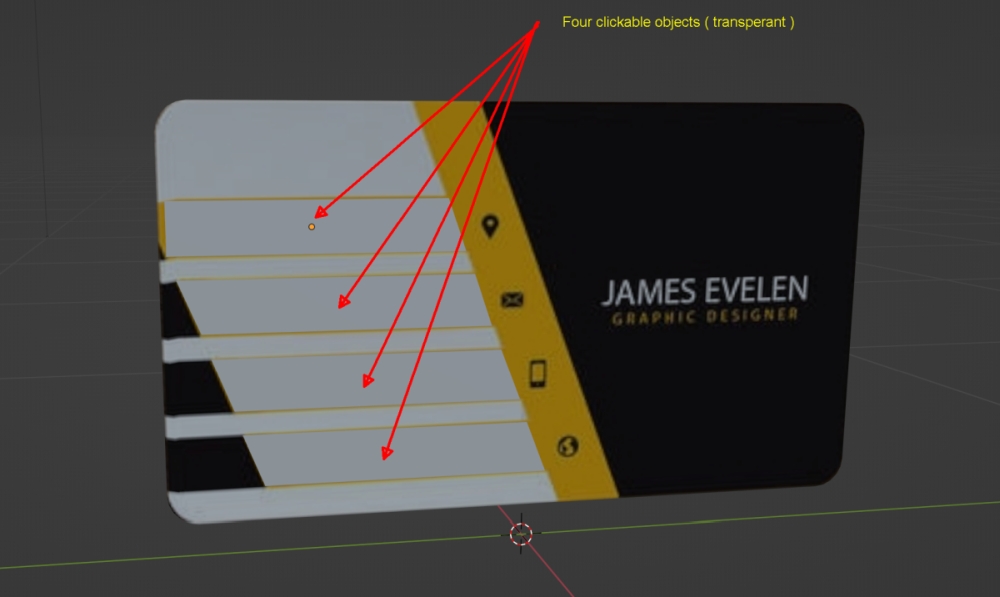

I am a big zero in coding lol.I have attached a file.
Its a simple card on which there are four objects which will be transparent. when user views them on mobile he should be able to rotate & pan freely. however these four objects are on back side& they should become clickable ( to their specific url ) only when camera rotation & panning stops.
There can be a provision to stop / start viewing camera motions.I have attached screenshot with marked up & also the blend file for better understanding.

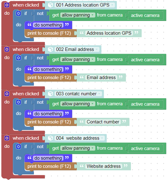

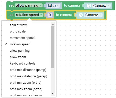

2023-01-01 at 3:24 pm #59318kdv
ParticipantI see there is no puzzle to disable camera movement
Two puzzles below do the same

2023-01-02 at 10:48 am #59329kdv
Participanthowever these four objects are on back side& they should become clickable ( to their specific url ) only when camera rotation & panning stops
just add a condition to check whether the camera is stopped or not
