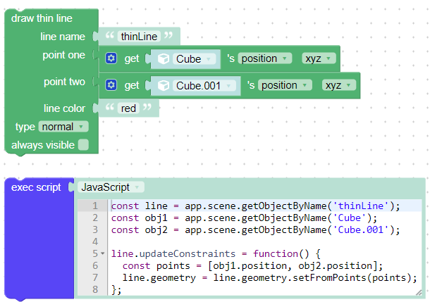

ParticipantI need a line that is drawn between the two objects to stay connected.
smth like this https://v3d.net/a4k?
2024-06-17 at 4:29 am #74893
xeonCustomerYes.
Tutorials - https://www.xeons3dlab.com2024-06-17 at 7:18 am #74902kdv
ParticipantIn your case you don’t need to draw a new line every move. Just draw the line between objects once and then update its geometry according to the objects current position.
