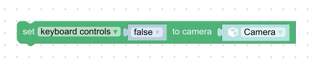

    yes you can do this with this puzzle:
    #51212
    boka5
    Cool,
    seems straightforward.
    I just need a new version.
    Thank you, Yuri.

    you might find the relevant piece of code in the human-readable you_app_name/visual_logic.js generated from this puzzle.
