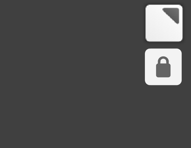

    How can I create a button below the Full Screen button that locks the smartphone screen? When the user clicks on this button, the 3D model will be static and inaccessible because the button disables the touch actions (click, touch, tap, zoom, pinch…).

    #43999
    Unfortunately I am once again baking textures and can’t stop it to test this theory but you can give it a shot.
    Since V3d allows multiple cameras I would set one up with the usual controls and a second one with no controls.
    The lock button would then switch between cameras as well as toggle a flag regarding its state.
    Any interactive buttons/ hotspots /click /hover events would use an if statement to determine if they should fire based on the Lock Screen flag.
    Seems doable.
    #44037
    fabriciomira
    Great idea! I’ll try and then I’ll tell you if it worked. Thank you very much!
    #44057
    fabriciomira
    It worked, thanks a lot!!!
