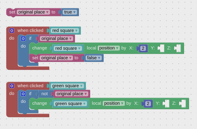

    Problem1:
    In attachments ( myproblem1.pdf ) you can see function to move an object from point A to point B.
    I don’t know how disable all when object is in point B.
    How is it possible ?
    Problem2:
    In attachments ( myproblem2.pdf ) you can see function to move two objects from point A to point B.
    I don’t know how disable object (green square) if the object (red square) isn’t in point B.

    #11825
    You can implement that using variables.
    Attached an example for you.
    #11852
    Emma
    Hi Yuri,
    Thanks for your fast answer.
    Immediatly I try it. I thinks that I’ll change only your coordinated positions with my animation.
    I don’t hope to meet obstacles ;-) (I’m a beginner)
    I’ll keep you update asap.
    Thanks
    #11884
    Emma
    Perfect Yury, superthanks.
    I managed to solve my test :mail:

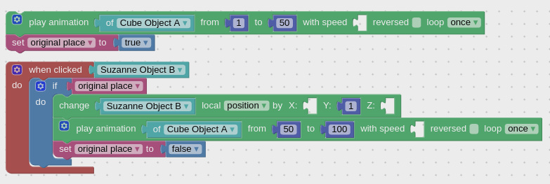

    I ‘ve only a question:
    If I ‘ve an object with animation like this example:
    Object “A” move from frame 1 to 100 in Blender.
    In puzzle I want that “A” move from 1 to 50 and when object “B” is in a correct position, only in this moment, object “A” move from 50 to 100.
    I do not know if I’ve been clear :wacko:
    Always thanks
    Emma
    #11886
    #11893
    Emma
    Hi Yuri (omnipresent) ;) ,
    Yes, it’s similar.
    Cube A move when I clicked it ( 1-50 )
    Also Suzanne move with the mouse click.
    When Suzanne animation is finished, when I clicked on Cube A, it’s move from 50 to 100.
    I try your example
    Thk
    Emma
    #11915
    sure! let me know how it goes
