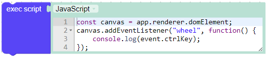

    I would like to detect ctrl + mousewheel on my app and solve it with puzzle since its so fun.
    In Javascript its like:
    document.addEventListener("wheel", function(e){
    	console.log(e.ctrlKey);
    First i’ll take the on mousewheel event block from html, but how do I get the KeyboardEvent.ctrlKey property then?
    :bye:
    #56205
    kdv77kdv
    you can’t add any working ‘wheel’ event listener to window/document/body while zooming is enabled. e.preventDefault() ignores all of them. to make it work add an event listener to the v3d canvas
    #56213
    noname
    oh okay thanks i’ll solve it with javascript then. Do you know how to use ‘in parent docs’ in javascript? I need to control a html-element in parent docs inside my listener.
    #56216
    kdv77kdv
    parent.document
