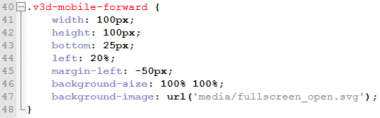

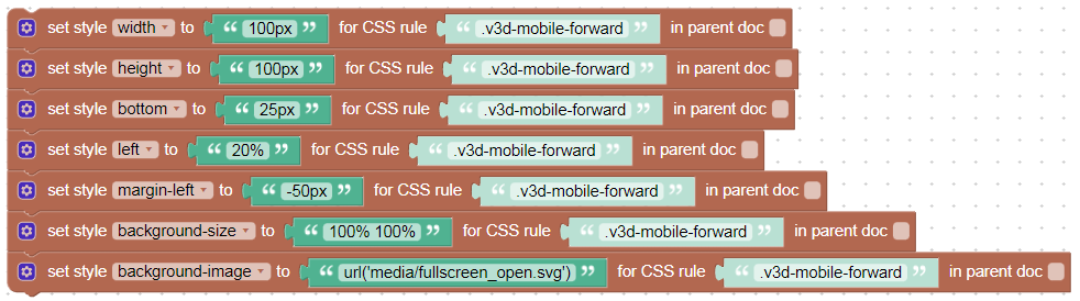

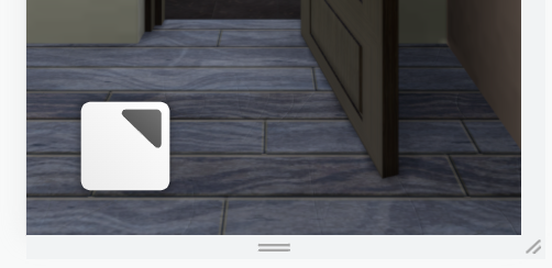

    #63699
    1. Swap it out for one I have created
    2. Move its location
    Add an additional rule in your_app_name.css and change whatever you want
    Or you can do it this way via puzzles with the same result. But the first variant is a little simplier.
