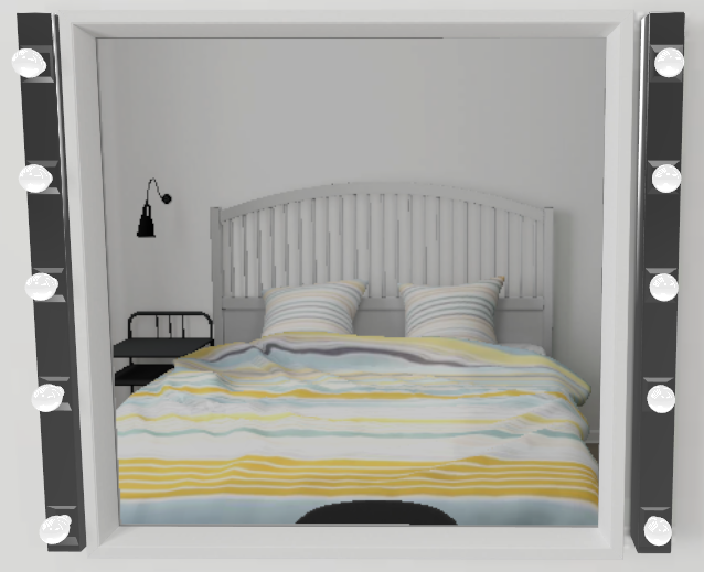

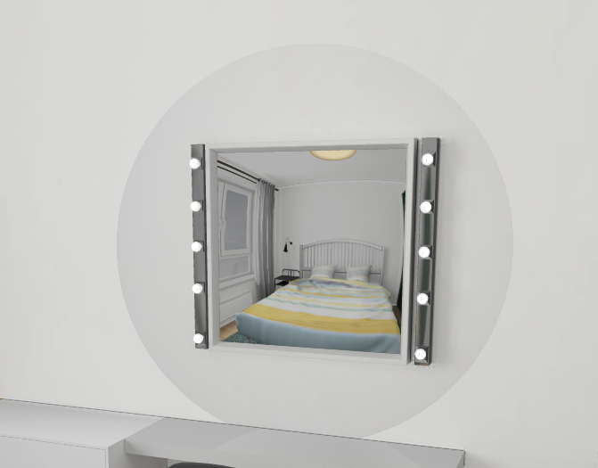

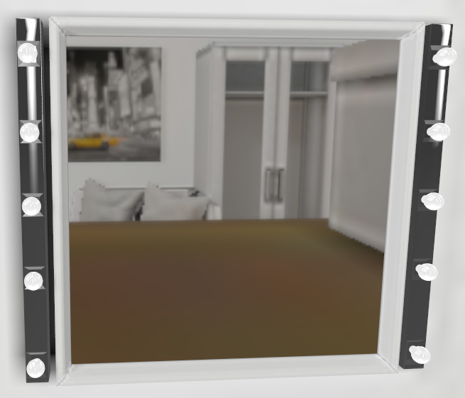

    If the reflective plane has glTF 2.0 compatible material the reflection is inverted
    MeshStandardMaterial. Wrong. It’s the neighbor room.
    MeshNodeMaterial. Correct.
