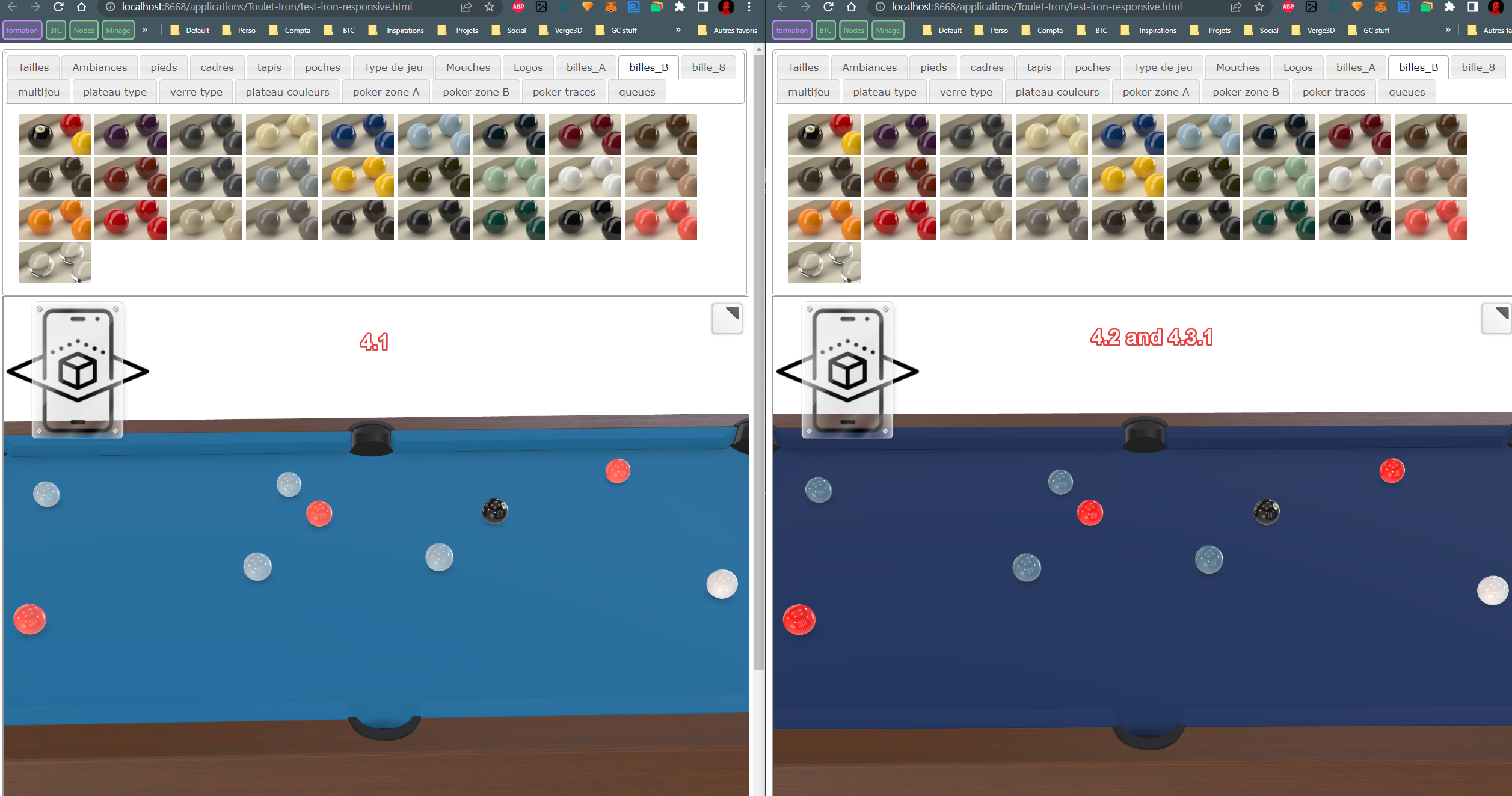

    I’ve a big problem here : i wanted to update my project’s app, and all colors are changed.
    Please see screenshot, and this temp link for another project : https://v3d.net/jat
    with the bed link, click / double click on the floor to go from RGB (0.0 to 1.0) to CSS (0 to 255)
    screenshot below for this small puzzle.
    On the second screenshot, you can see that the same app (once lunched as 4.1 non-upgraded on the left : good colors), and launched direct after upgraded (rounded green arrow) on the right.
    Same choices, same CSS colors.
    So maybe from 4.1 to 4.2 you changed some default gamma, or color management ? Is there any puzzle to make it go back to old color management / set gamma ?

    Tried also with Verge3D 4.3.1 : same color change.

    Hi Claudio, there was an issue in the CSS color correction which was fixed in Verge3D 4.4 pre1. You might try this version to see if it’s the same problem.

    Tried 4.4 pre1 : still not working…
    I mean the CSS color (gamma ?) is not good :
    Here is the test (double click / single click on the floor to switch from CSS to RGB):
    https://v3d.net/jat
    #63554
    re-save puzzles after updating to 4.4.0 pre1. They fixed CSS to RGB conversion in puzzles.min.js in the setMaterialColor() function.

    Thank you, now colors are ok ;-)
