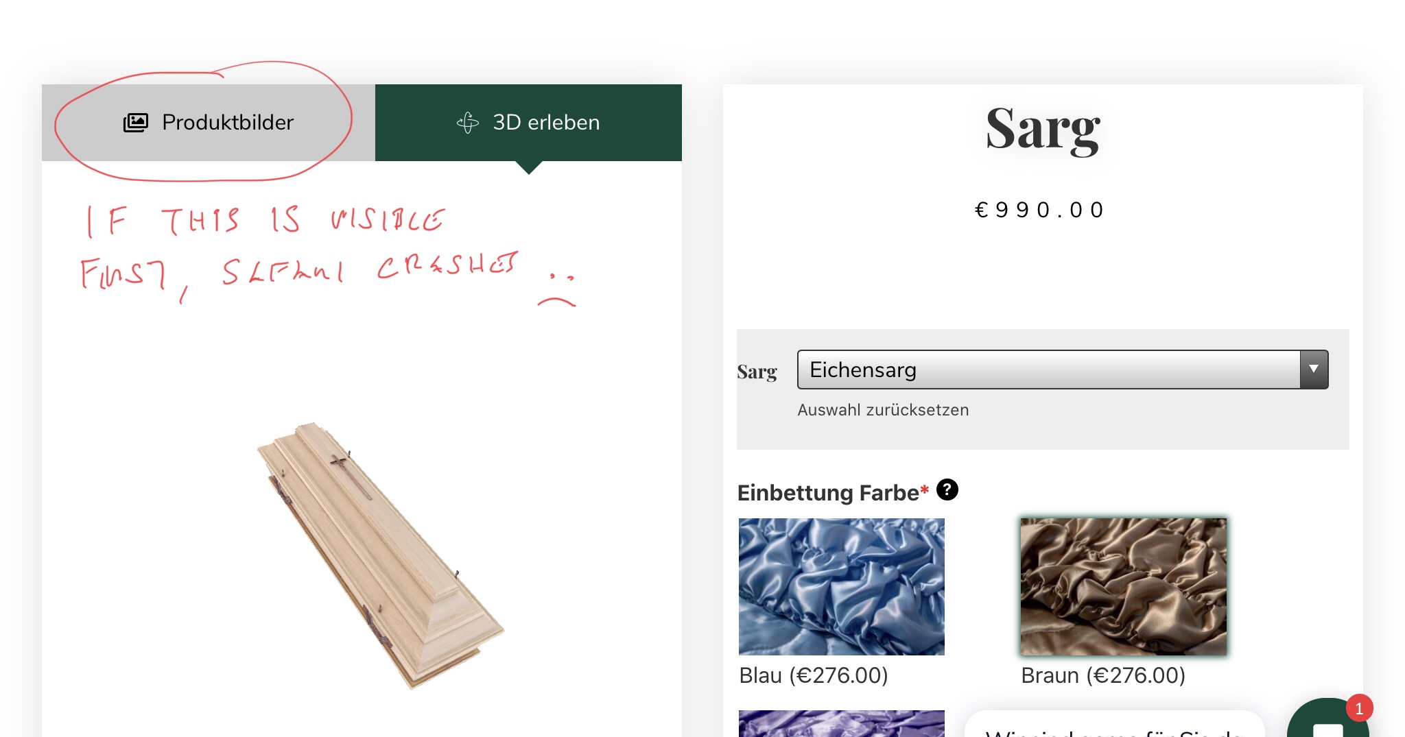

I have tested the app on the final wordpress/woocommerce shop and noticed that when verge is not visible for the user first (productimage in woocommerce so we can load in background for the user), safari on iphone crashes randomly. (Site needs to be reloaded…) This happens only on ios iphone, not on; ipad, safari for mac, android, chrome(win10).

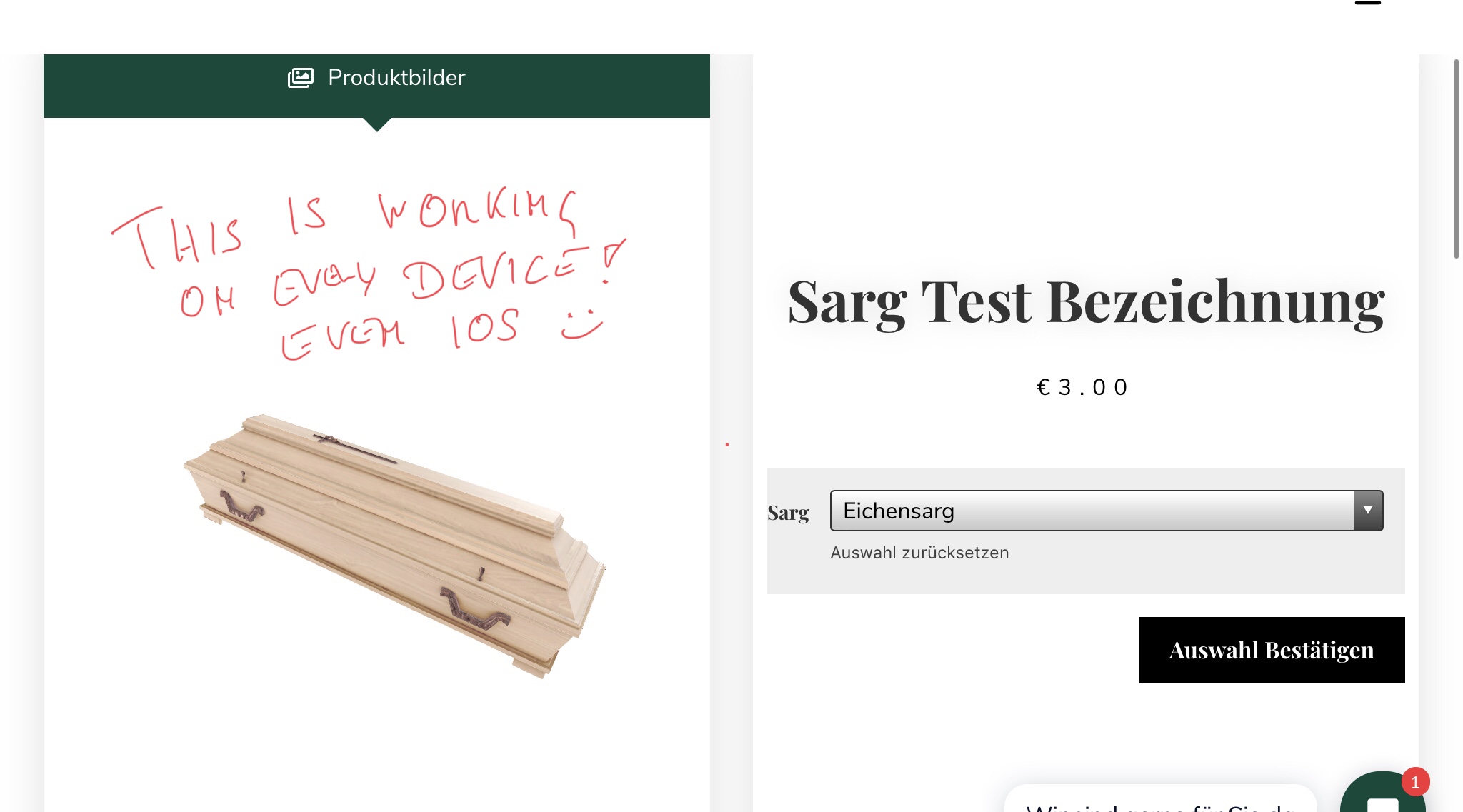

If i dont implement the productpicture, so that verge is visible asap, the app works fine on every device tested.
