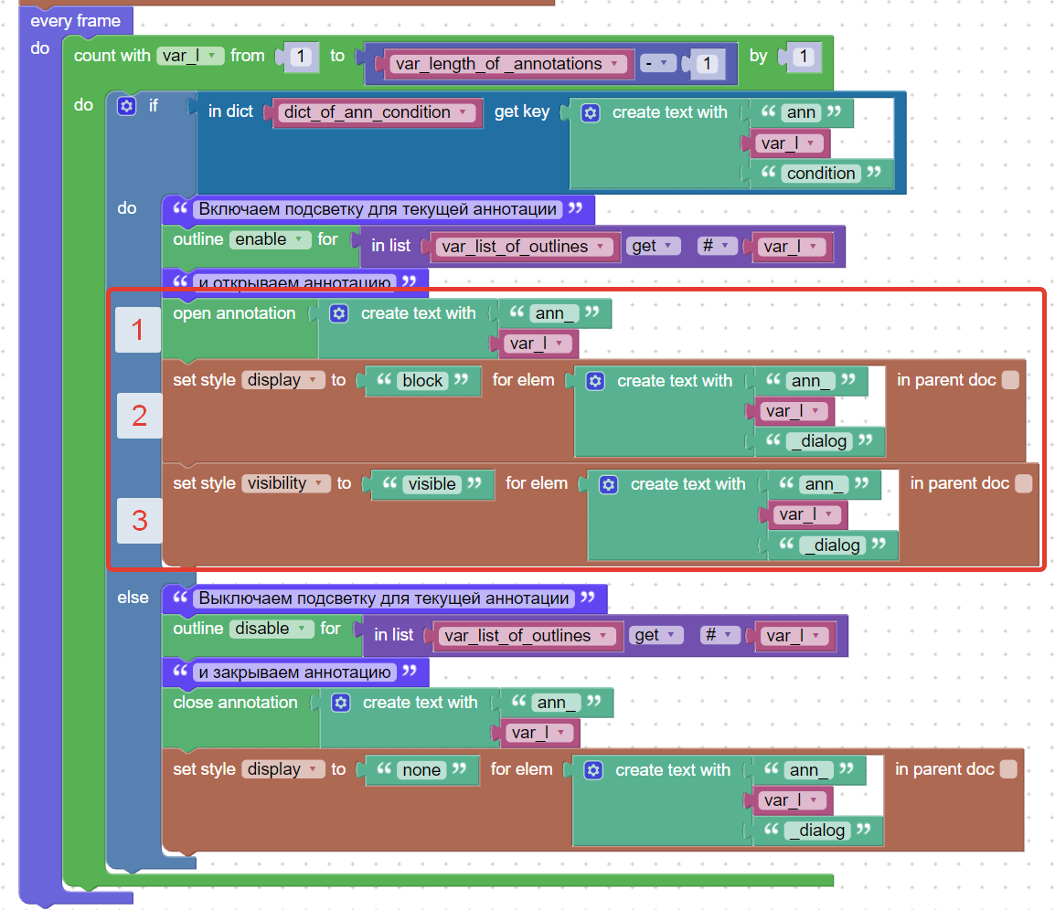

Alexander KovelenovStaff2021-08-13 at 8:11 pm #43648kinchew
CustomerHi!
I also have this problem. I need to control the show/hide using the status of a variable. Currently, I have a situation where the variable is in the True state, but none of the three options for opening the annotation works.
I would like to have more control over the behavior of annotations, at least the ability to disable the automatic show/hide mode on mouse click.Attachments:
