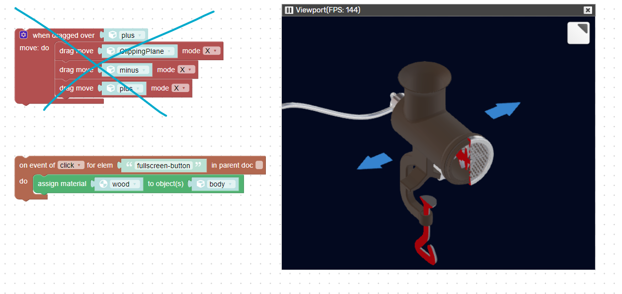

    Hi! I’m trying to solve the problem with a clipping plane that doesn’t work in certain modes in my app and I just found out that it stops working after using the “assign material” puzzle. This problem can be easily recreated in the Clipping Plane tutorial app. Below you can find the screenshots that recreate/present this problem.
    Any chance we can make the clipping plane to work properly after the object’s material is changed by puzzles?
    #67875
    initially no object with wood is in the group of influence. replace wood with steel or plastic and it will work as expected. that means you need some object with wood assigned in the group of influence.
    #67877
    Mariusz
    It worked, thank you very much! :good:
